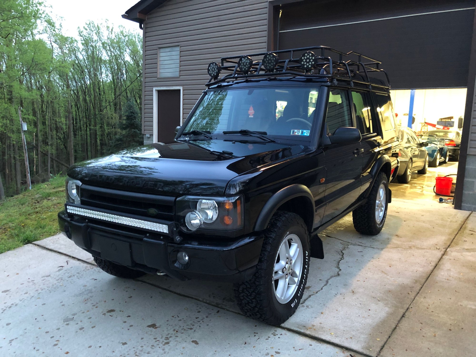

Default 265/65/18 Goodyear Duratrac's
Here is a pic of my 2002 Disco with a 2" lift and 265/65/18 Goodyear Duratracs. Very slight rubbing on the stock front bumper. Just had to trim a bit and trim the front inner fender liner. In my test fit my Arb number (not yet installed) clears it fine.
