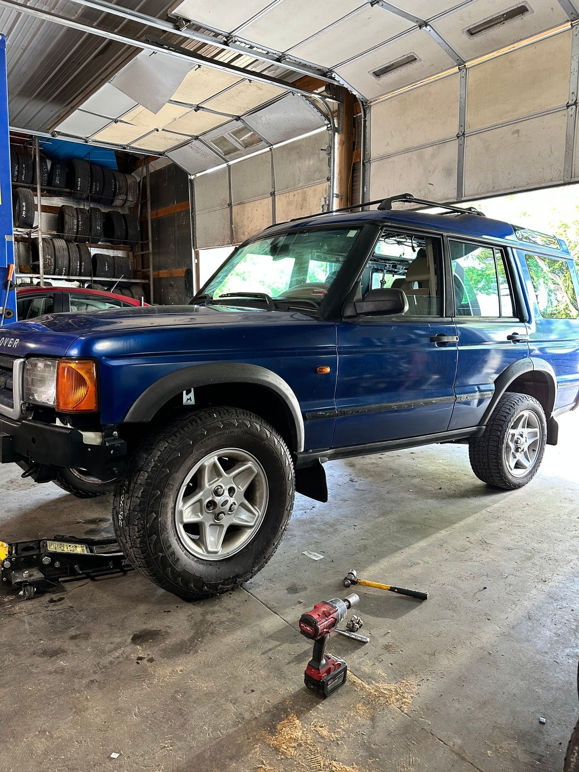

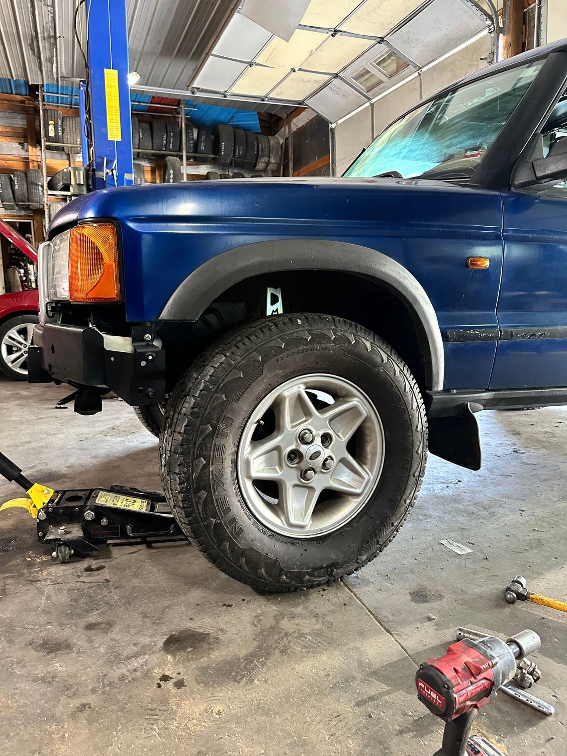

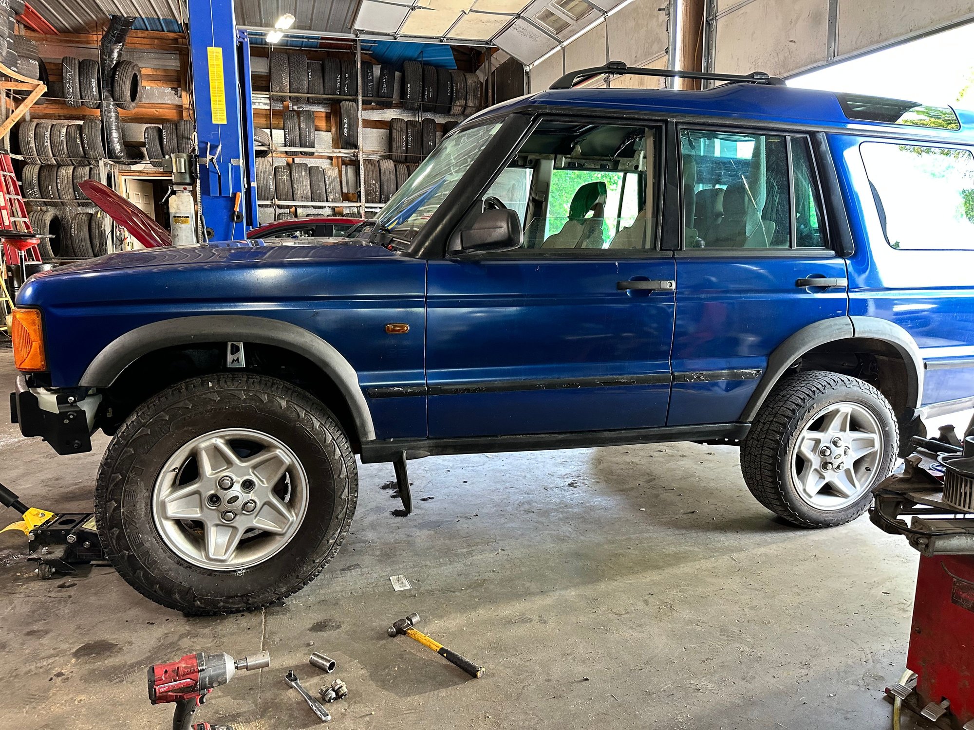

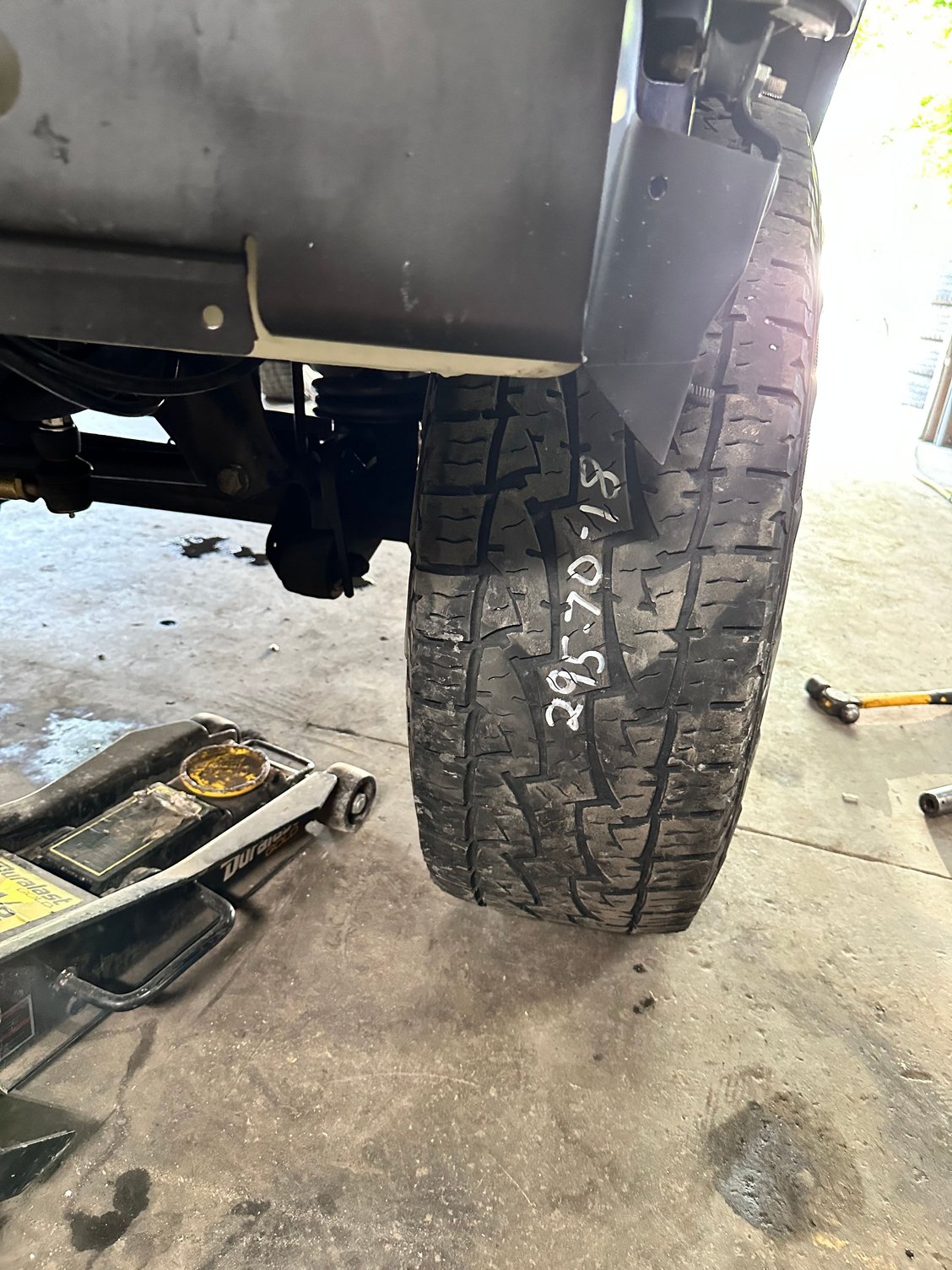

Default 295/70/18 fits Disco 2 on a Terrafirma Medium 2” Lift
The 295/70/18 (34” tire) fit with a Terrafirma Medium 2” Lift !!! They made the vehicle sit A LOT higher. I tried just one AT tire at a tire shop when they did not have 275 and 285. Minimal rub in one area and that was front rear lower against plastic rocker which I cut have easily cut and not been noticeable.
I saw the weight of that tire at 69.2 lbs each! So I decided it was going to be way too much for the engine, transmission, and gears.
I ended up buying 265/65/18 in an aggressive 31” tread. They only weight 37 lbs each and ride nice. The spare even fit lifting it up to bottom two holes.
But check out these photos on that 34” tire. 2” lift! 2001 Disco 2

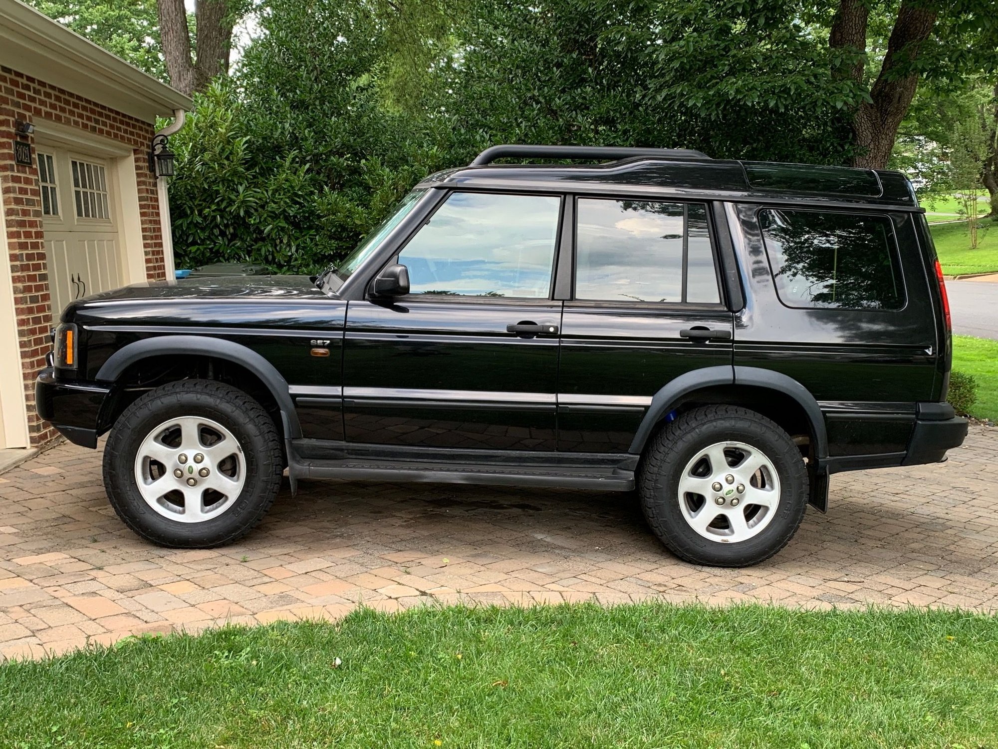

Originally Posted by Rich Spiess
Here is a pic of my 2002 Disco with a 2" lift and 265/65/18 Goodyear Duratracs. Very slight rubbing on the stock front bumper. Just had to trim a bit and trim the front inner fender liner. In my test fit my Arb number (not yet installed) clears it fine.
Aesthetically and proportionally I feel like the 2” lift is ideal for these. Great looking truck.
