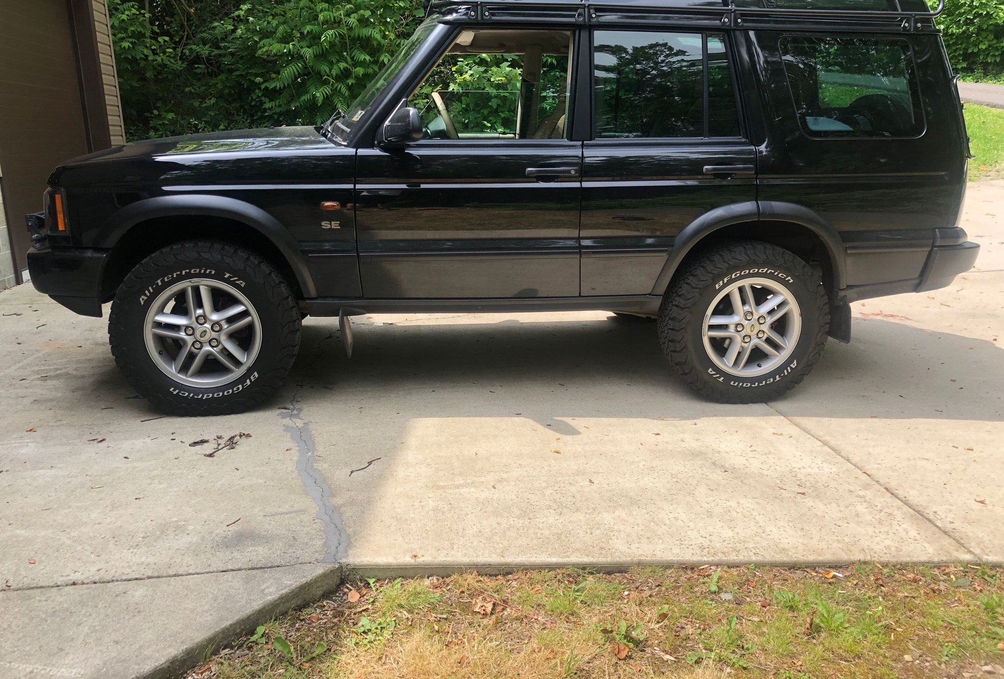

Bad angle picture but it’s not even close to bumpers or arches

Originally Posted by escott16
275/65r18 never had rubbing after 10k miles. 2” tf md lift
sold doing the same thing. Nice shop

My only complaint is that they don’t stick out like I would like. I like the flush look so I’m gonna invest in nice spacers , I do regret not getting the 16” wheels but I need to find the challenger wheels that the defenders had. And I only put a few thousand miles a year on this so it’ll take forever for these to wear out

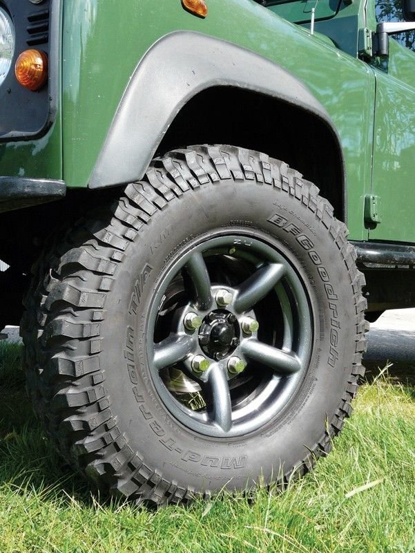

Ride is a tad stiff for my liking but I with overall plans for sliders and arb bumper I figured I’d go stiff with adding more weight . And the 16” just look better and ride better these are the ones I want but they have to be shipped from Europe to Pennsylvania so that’s gonna have to hold off

LT255/55R18 OD=29" (Stock)
LT265/60R18 OD=30.5"
LT265/65R18 OD=31.5"
LT275/65R18 OD=32"
https://tiresize.com/calculator/
Old Oct 2, 2019 | 11:08 AM
Best4x4's Avatar
Posts: 7,997
Likes: 2,506
From: Beaumont, TX

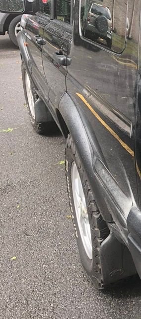

255/70R18 = 32.1x10, it’s the width that’ll get you when you turn lock to lock. Bumper end trim/splash guard lining, control arm, and lower rocker plastic could all rub on a tire wider than 10inches.
I ran 255/70R18 on a 1inch lift with very little rubbing on the front bumper corners. With a 2inch lift it was great! 255/70R18 reminds me of the tall/skinny 235/85R16 on a D1.
if you add spacers = rocker trim will certainly need to be trimmed.

305/60/18 will rub & will need trimming on 2”
i wouldn’t recommend this if your not ready to tackle more at the same time.
