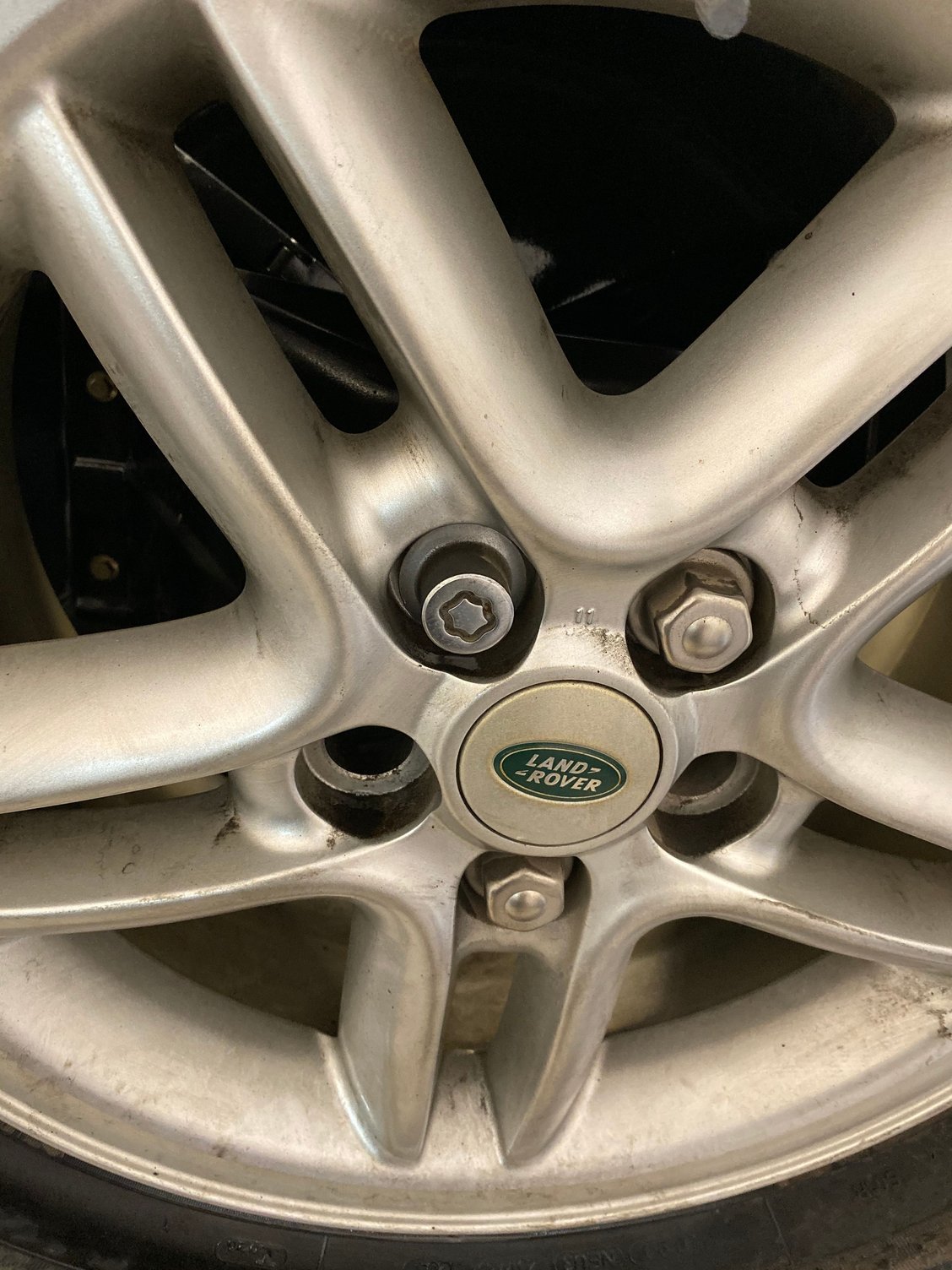

So I hadn’t taken the spare tire cover off and I’m seeing an issue here. Anyone know where I can find a key for this thing? Is it a genuine LR part? Jesus 🤦🏻*♂️

I work at a dealer we have lots of cars come with these on without keys, is it the best way maybe not but it works. Just grabs 12 point socket that’s slightly smaller and pound it all the way on then it should come off with some force

honestly I wouldn’t mind the lock ... anyone know what brand that is?

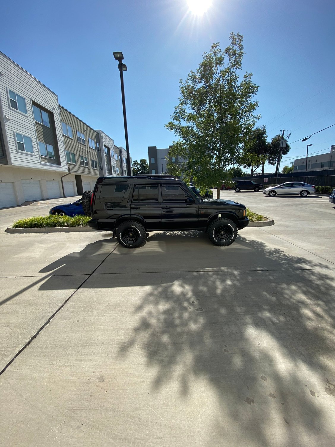

Thank for all the help guys.... went with 265/75/16 BFG MUD and Terrafirma rims

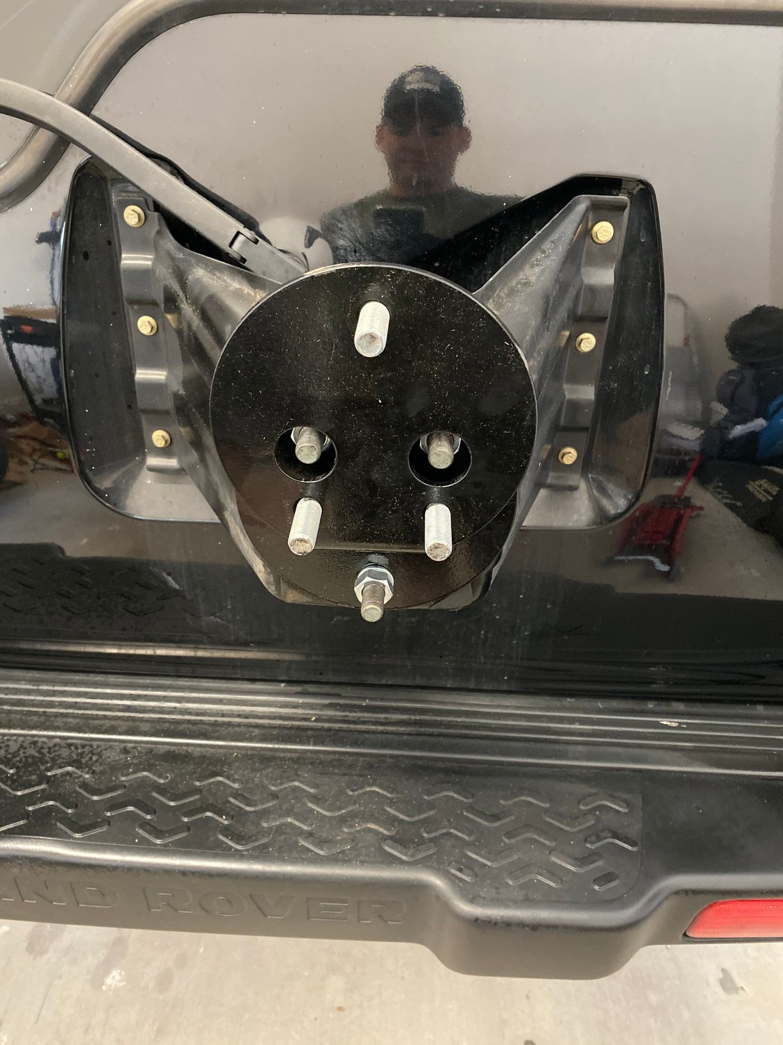

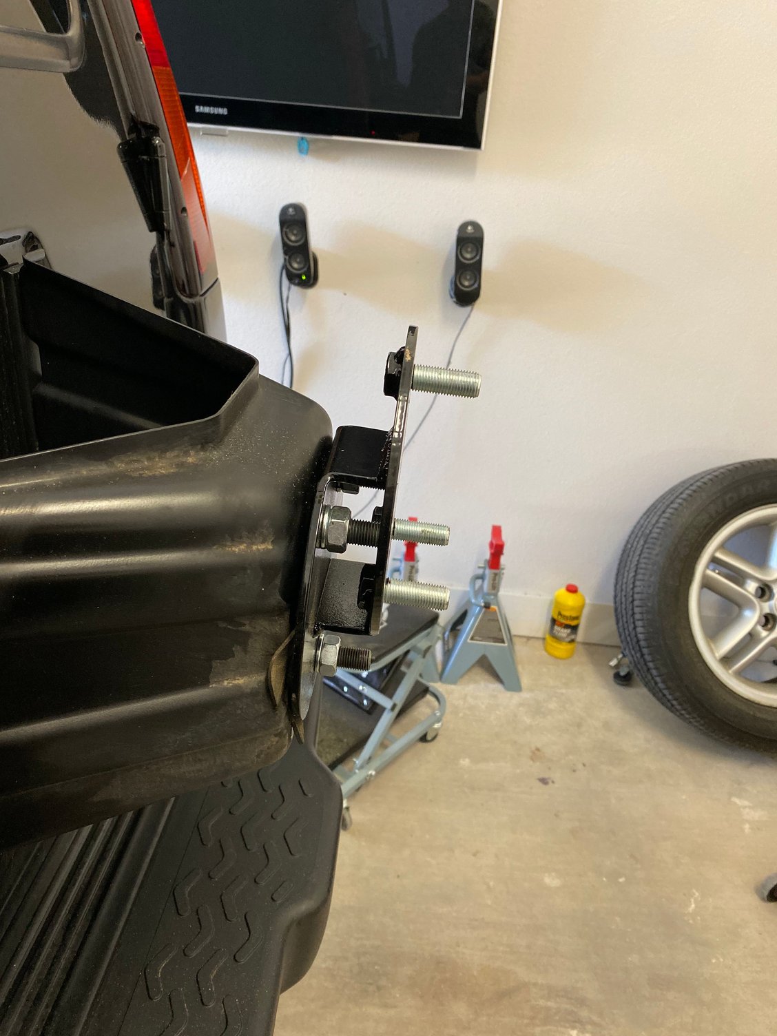

The adapter worked great
