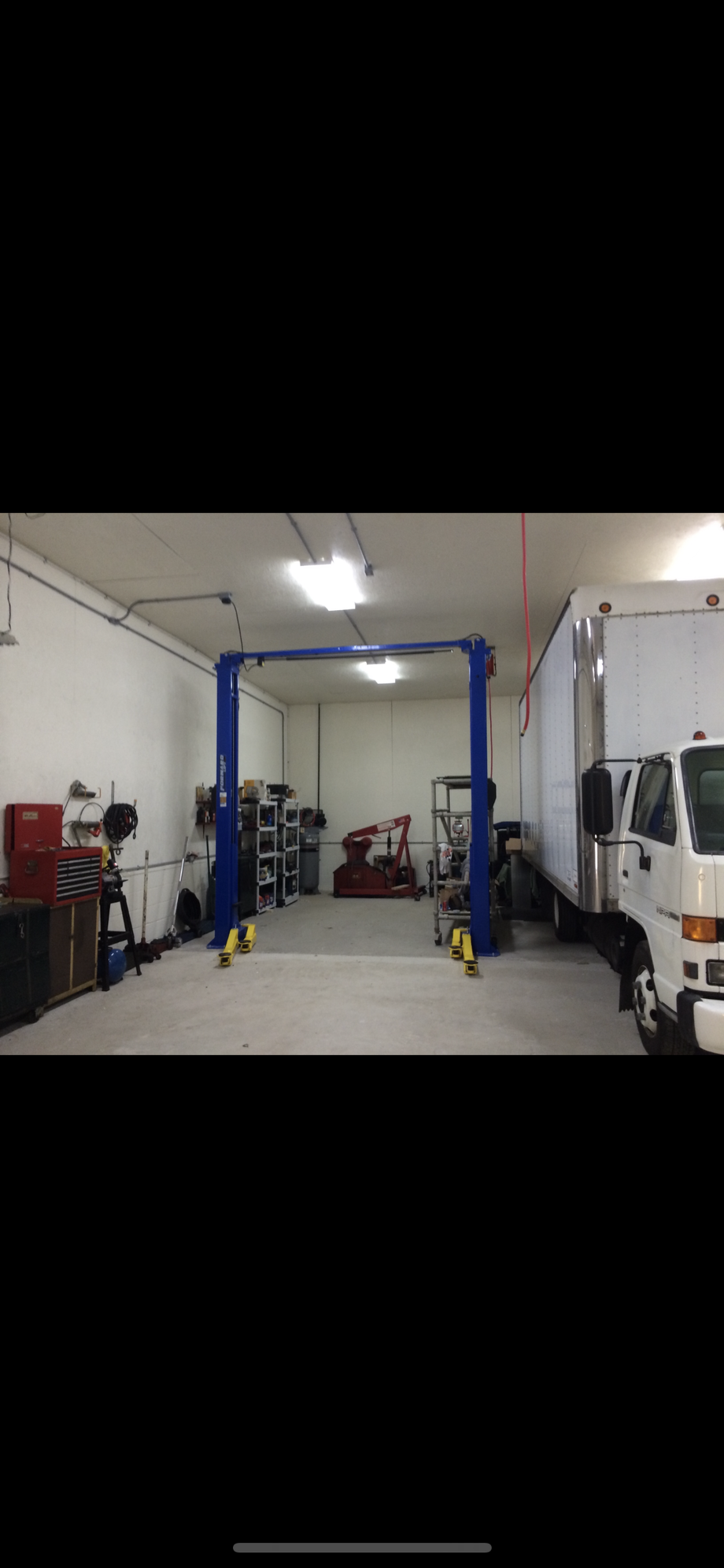

This is what I use

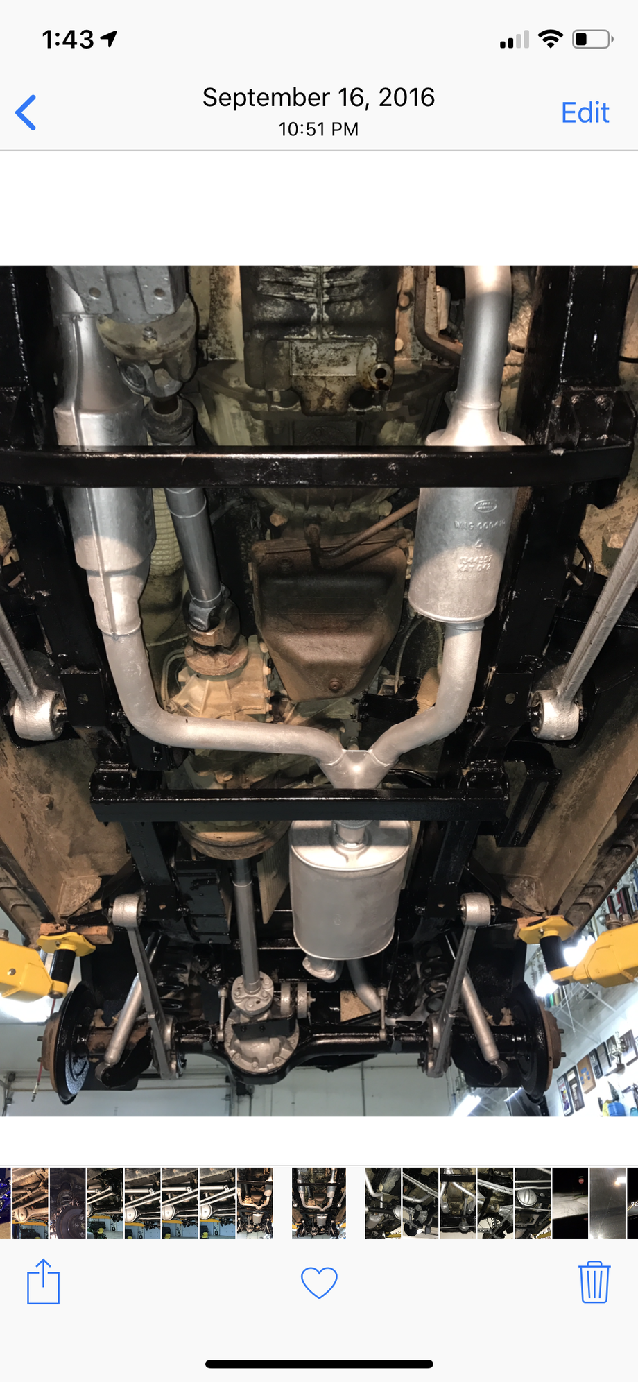

What do you use for the lift points though? My gut says as far towards the ends as I can get on a flat part of the frame.

not the best pictures but you can catch the drift , I do it on the metal with wood blocks not to damage anything , did it 20 times never damaged or had issues
Old Dec 12, 2018 | 06:57 PM
2 post lifts are fine as you can see. I used a 2 post on my LR3 and it weighs way more than the D2.
This is EXACTLY what I needed! Thanks man!!!!
