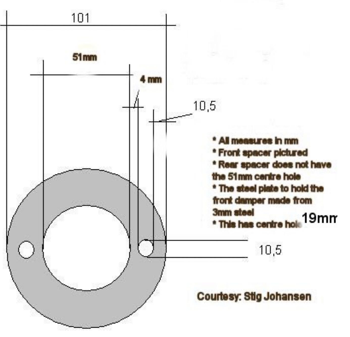

Hey all,
I have a 2000 D2. Im looking to lift it 2". What are the issues with just milling some spacers on my mill? All I find online are the springs/shock kits. Im taking the D2 to Moab in Oct but other than that it a soccer moms D2.

I was in your boat a while back RE: spacers vs new springs/shocks, I went with new springs and shocks for 2 reasons: 1) Your shocks are probably WAY past their prime and need to be replaced anyway, and if you’re gonna do that you might as well get some new springs in there because those are probably pretty tired too. 2) A spacer doesn’t increase the articulation of the wheel which is a lot of the reason you do a lift. But, I can certainly see just wanting the spacers given your use case, especially if you can mill them out yourself.
As far as a roof tent system is concerned I also run a a roof top tent, I think there are a lot of good options for the tent itself, the big question if how are you going to mount it. I have the extended roof rails but I don’t exactly trust them at their advanced age so I supplemented it with a roof gutter mounted ladder rack. I just bent the top of the gutter mounts over to support the tent from underneath and now it’s really solid plus I didn’t increase the height too much.
I’ll try and get a picture and I think I have the measurements of the the spacer geometry too (I was going to mill them out myself as well) if you want to go that route. Feel free to search for my username and post regarding my lift that I did for some pictures. I had never done any suspension work before but between the forum and the Atlantic British video I found the actual work to be pretty straightforward. In any case, start spaying the hardware with penetrating oil now so your wrenching goes smooth!

I am. The rear springs are a bit taller and heavier, so they lift the front about 3-3.5". Watts link is what is used on the rear end to keep the axle centered in the chassis instead of a panhard bar. It has the benefit of keeping the axle truly centered instead of having a slight side to side arc like a panhard bar.
