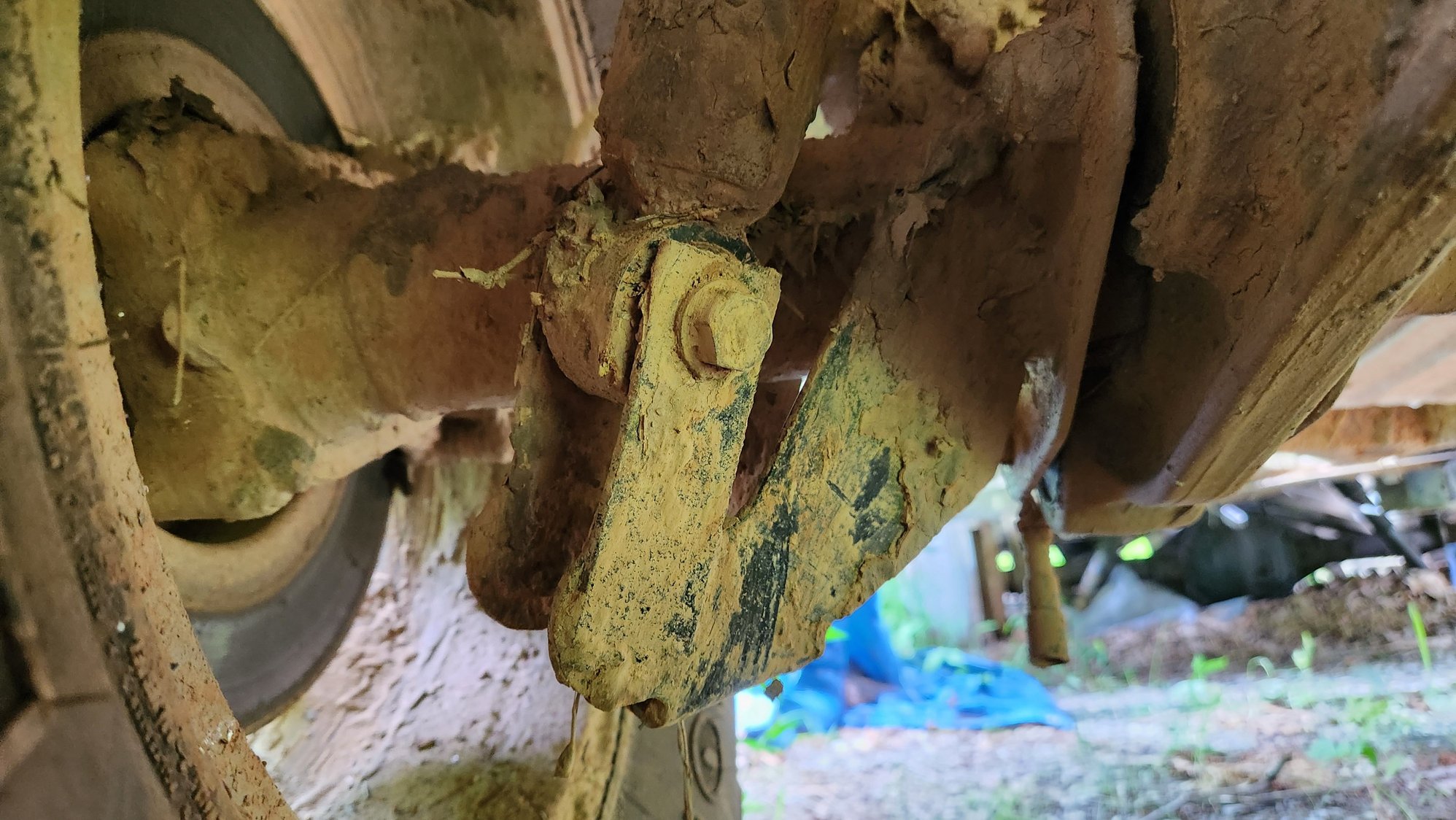

I always fabbed mine, but just as easy and nearly as cheap to just go on eBay and order a set of 2" shock extensions for a 99-06 Silverado that will bolt on.
If you'd prefer to fab, I've included a picture of my solution if you can see thru the mud. Just a couple pieces of 1.5" flat strap cut to length (probably 4" pieces for a 2" lift) and welded onto the lower shock mounts. Cut the welded on nut off, drill a hole thru, bolt the shock back in place and tack the nut back into your extension tab.
