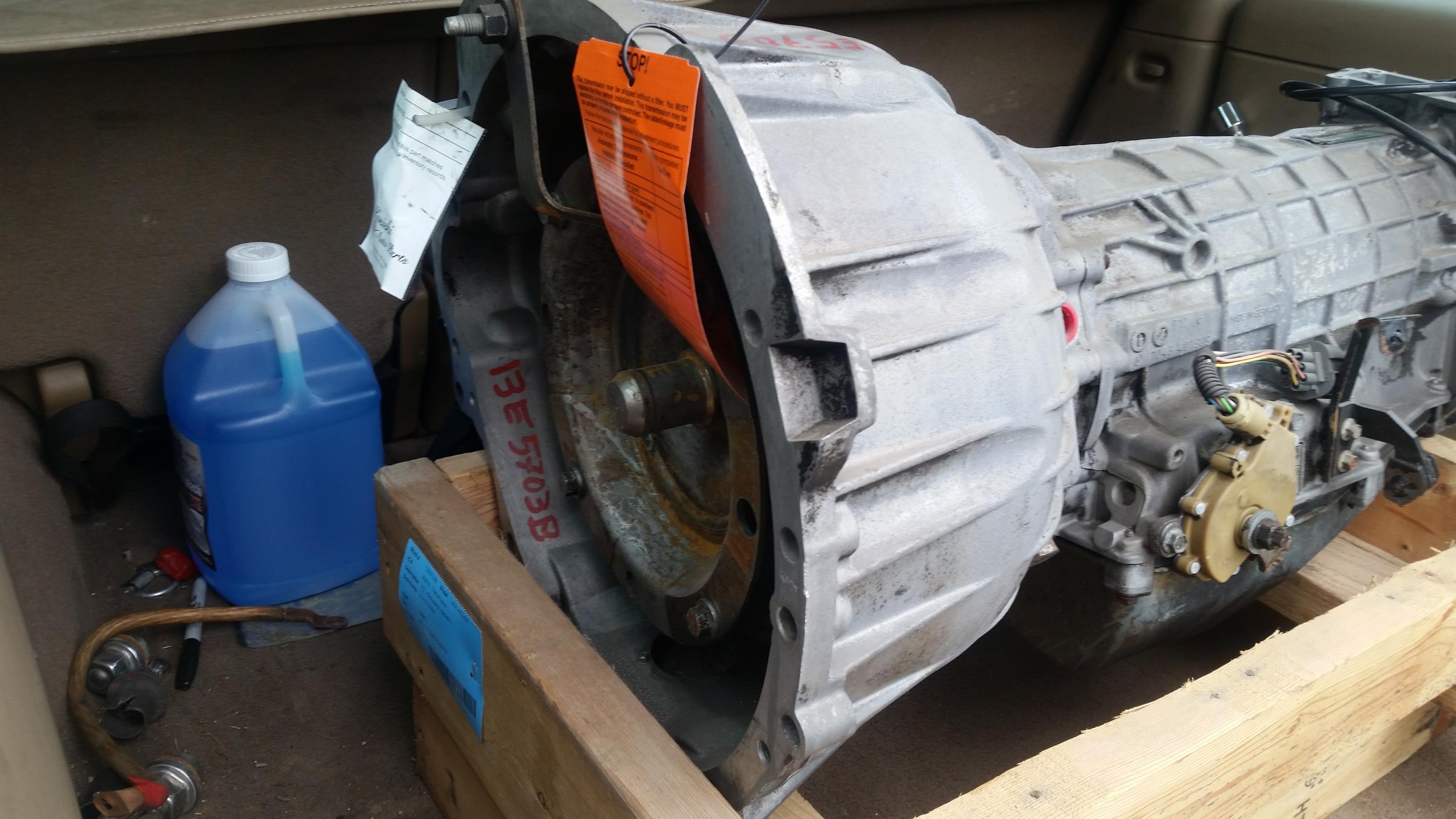

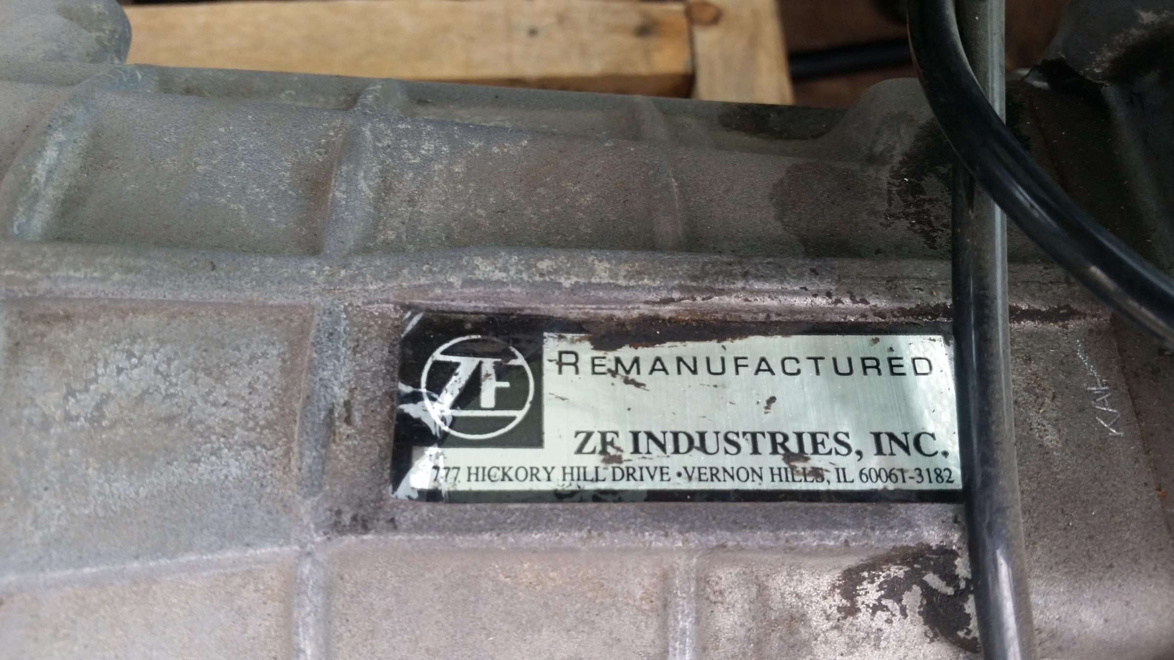

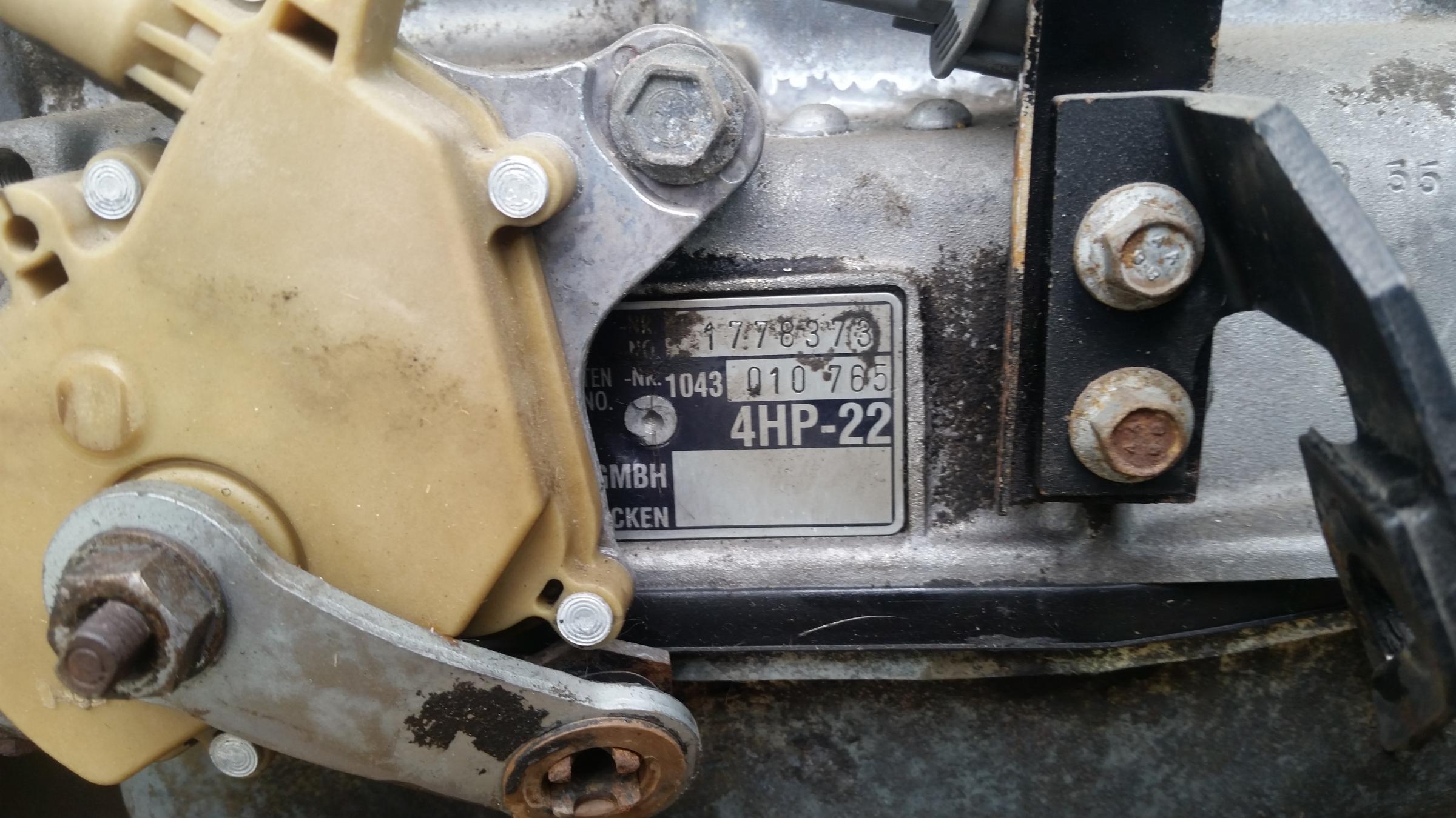

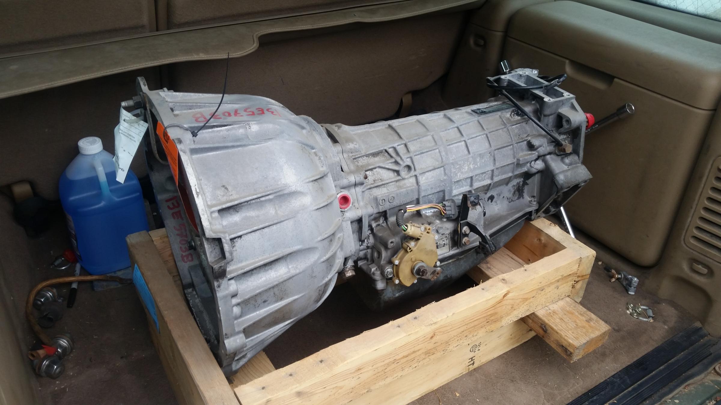

Well, there she is.... that's what $350 gets ya at the local salvage parts store. Tried to get at the truck it came out of but it was gone...

Swap your existing shift linkage arm onto the XYZ switch on the new transmission before you install it.
Then, sell your old XYZ switch and recoup 1/2 the cost of your new transmission. lol

Looks the the linkage lever at the XYZ switch is bent, you will need to straighten that out.
Install new trans, If the XYZ switch is good, sell your old one off the trans that is no good and recoup some of your cash.
Going rate it $100 ish.

Originally Posted by racer x
swap your existing shift linkage arm onto the xyz switch on the new transmission before you install it.
Then, sell your old xyz switch and recoup 1/2 the cost of your new transmission. Lol
beat me to it!
