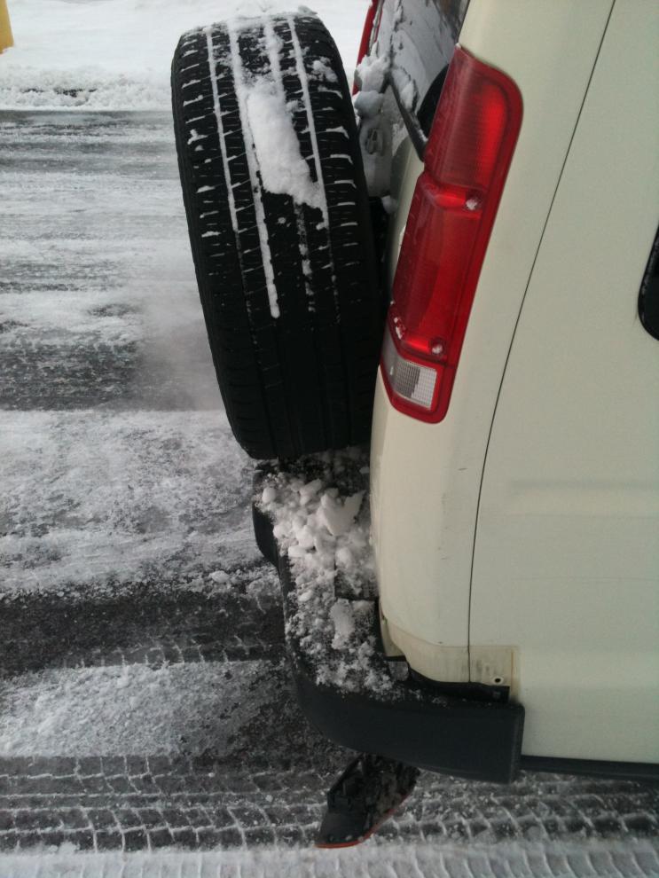

I was hit by a 2001 Infinity Qx4. It probably wouldnt have been to bad if he didnt impact the spare tire first. I think that is the only flaw with having the tire on the back door.
As you can see in the pictures he smacked me using his passanger side rear door. He slide into me sideways. He is wanting to just give me cash it sounds like to keep this off insurance. Either way I am fine with cash or insurance. Really dont like the fact that the estimator keeps talking about totaling the vehicle.
I will find out hopefully on friday.

Sorry to bring up an old thread but what happened to the Disco? Was there deeper damage than just what shown?
From what you've said and the pictures shown, is it just replacing the rear bumper and lights, rear door and reattaching the roof to the side pillar?
