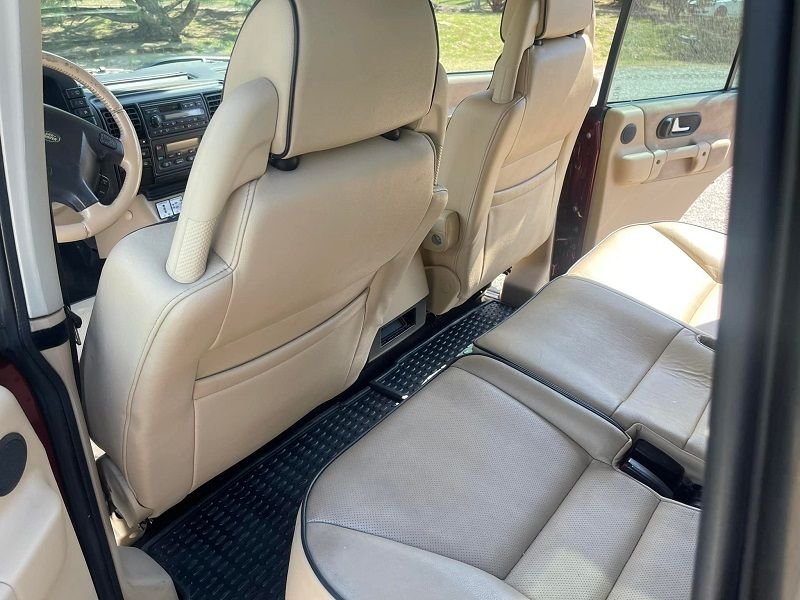

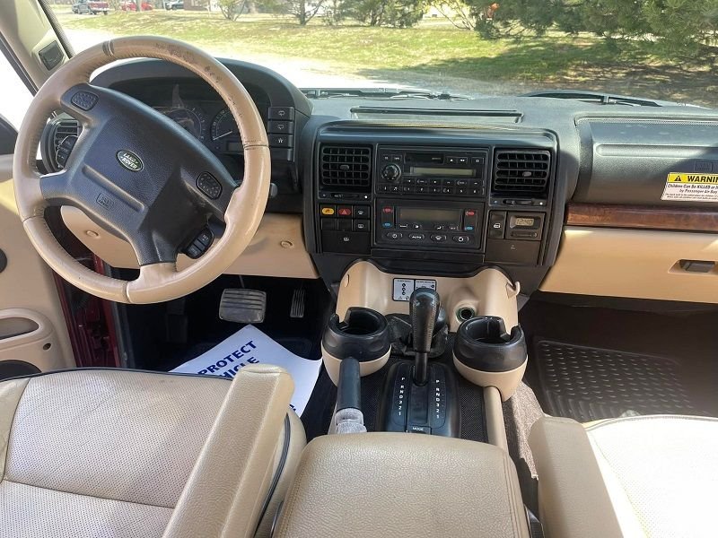

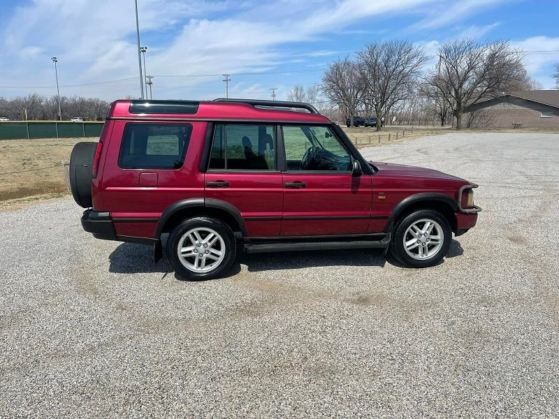

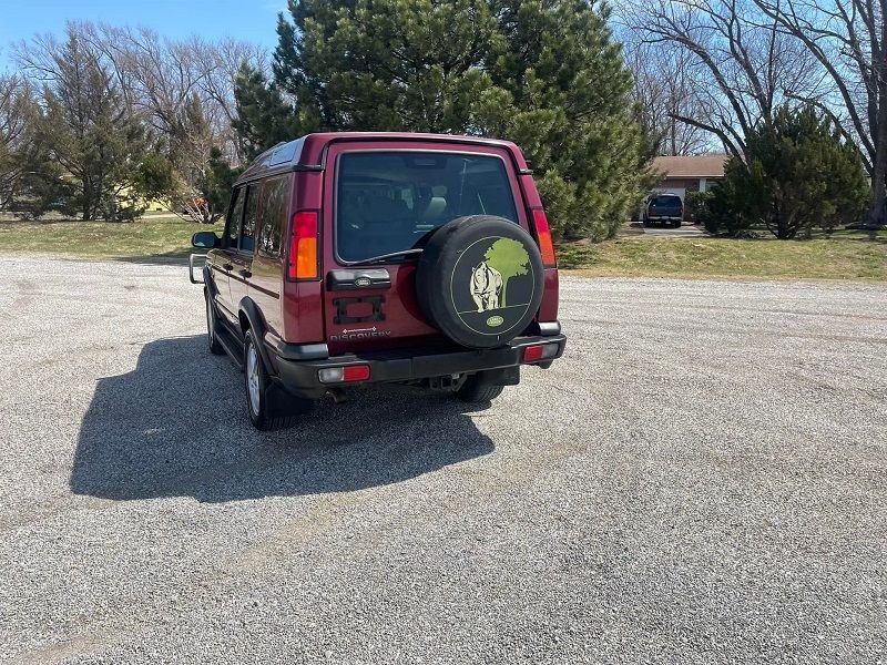

Just bought a 2004 D2 with extensive service history, three owners, head gaskets done by the dealership at 57,175 miles under the first owner. All services are documented and timely including oil changes, coolant flushed, brake fluid flush, AC charge, etc. A new Jasper long block was installed by the second owner at 115,492 miles. The vehicle currently has only 136,101 miles, so the motor has just 20,609 miles.
The color is Alveston Red with tan leather. Yes, the headliner needs redoing, so the sunroofs will be attended to as well.
Truck spent its life in New Mexico and Kansas. and will now be heading to Massachusetts.
Hood has typical fading
No 3 Amigos
I already ordered a Lucky8 greaseable front driveshaft.
Will change out the stock thermostat for the Britpart 180 degree one.
Service the differentials and Trans/Trasfer.
Get rid of the ugly grill/brush guard
Polish the headlights.
Being from New England I tend to look far and wide for something without rust. I hope a 2004 final model year with CDL, no 3 amigos, a new engine with only 20,000 miles doesn't bite me in the ***. Regardless, I am now committed.

Nice looking rig. It won’t bite you, just stay on top of the maintenance and don’t let it overheat.

Looks like Alveston is the new black…. My latest is an ‘04 HSE. Sounds like you are on the right path. Get the Rave and get ready as you’ll still have a bazillion fixes to do.
If you wanna get serious about diagnostics and the like, get a Nanocom.
The funniest part about yours is that it is very similar to mine in the interior in how the dash is curled up (I’m still on the hunt for a new one) and your coin and ash trays are buggered like mine (easy and pretty much free fixes I think).
