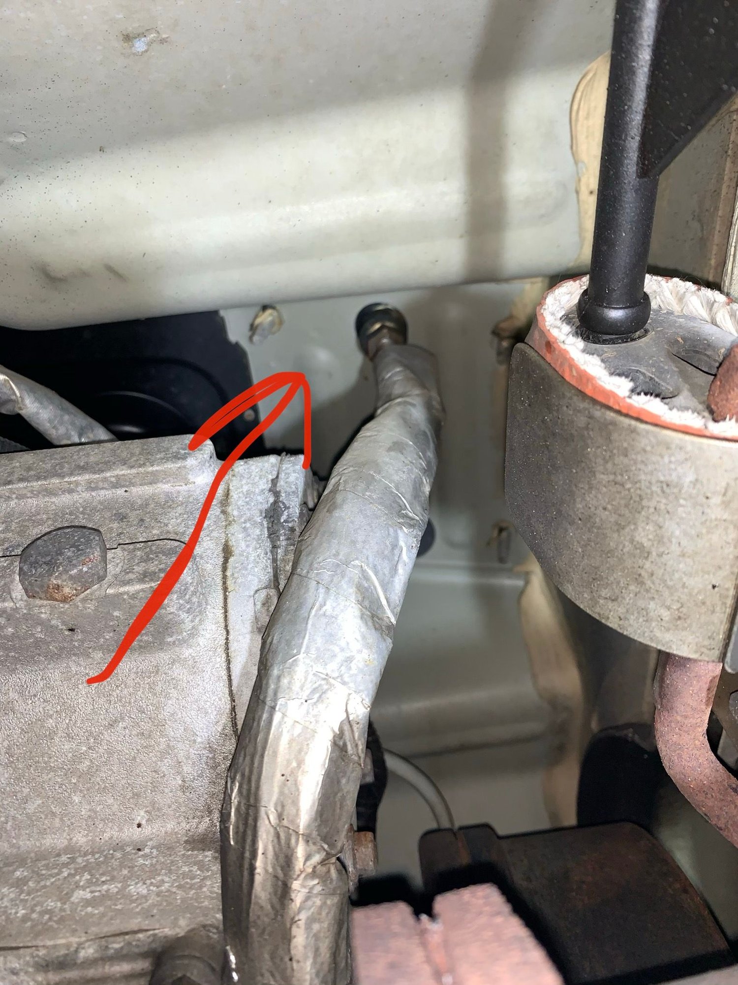

Default 2/19 Update
Had problems with heat coming into the cab. Had the muffler checked out and the said it was fine. I crawled up under there again and found some heat shielding missing. So I ordered this stuff off Amazon and installed it. Also found a place above the transmission that didn’t have any shielding so I partially covered that. We’ll see how this goes tomorrow.
The missing piece
What about this spot over the tranny?
It ain’t pretty but it’s in there!

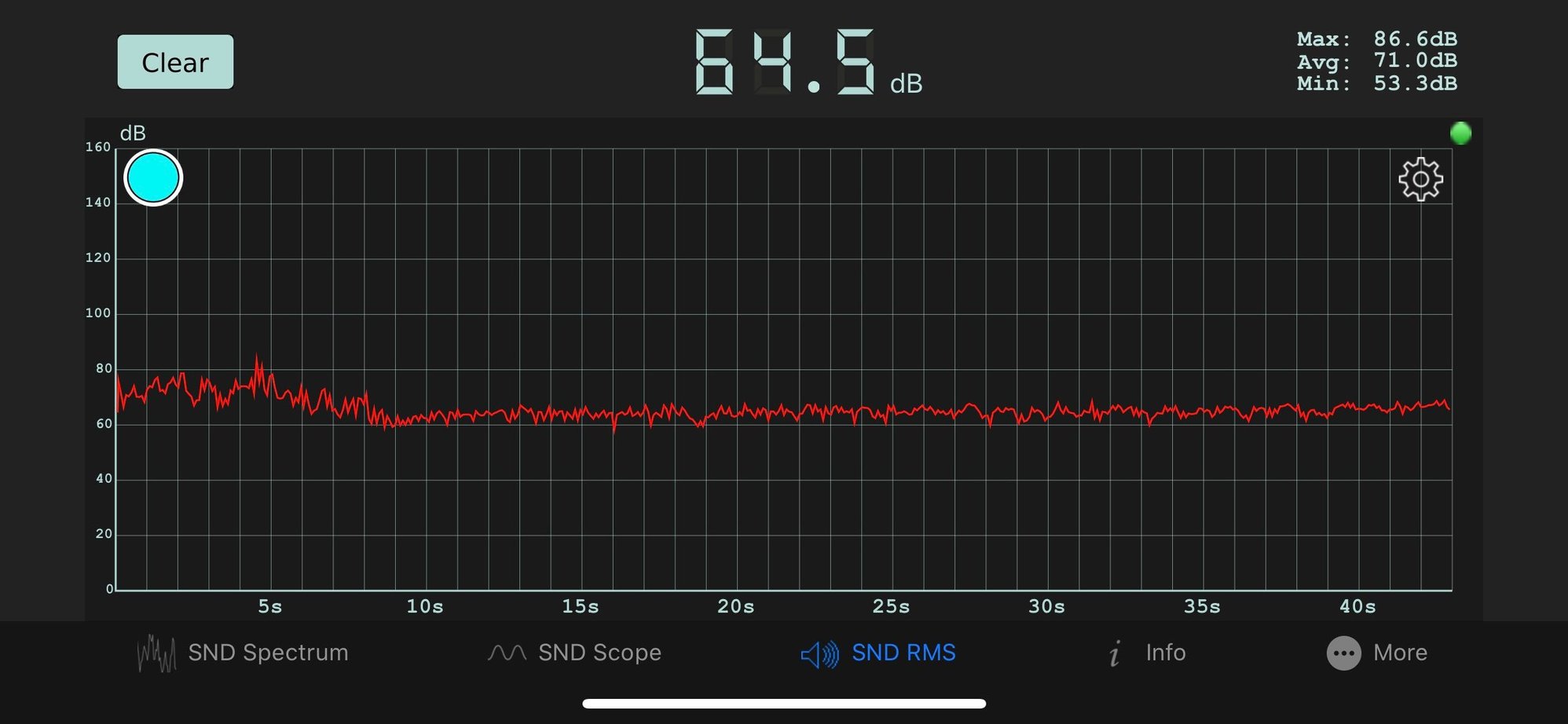

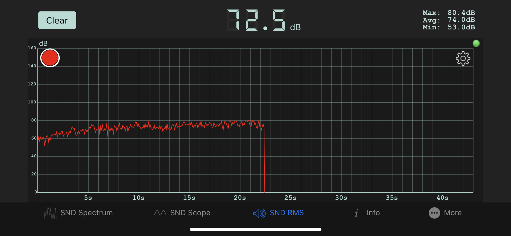

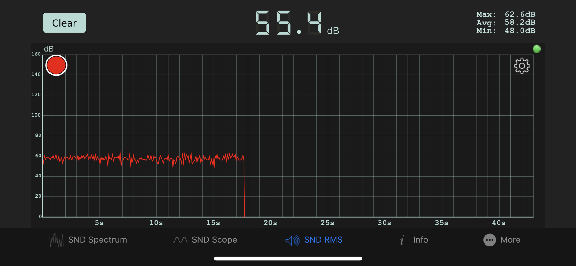

Bonus! Looks like it reduced the noise in the cab too. Take a look at my before and after decibels.
Idle before heat shield
Idle after heat shield
Idle to highway speeds after heat shield
Idle to highway speeds after heat shield.
