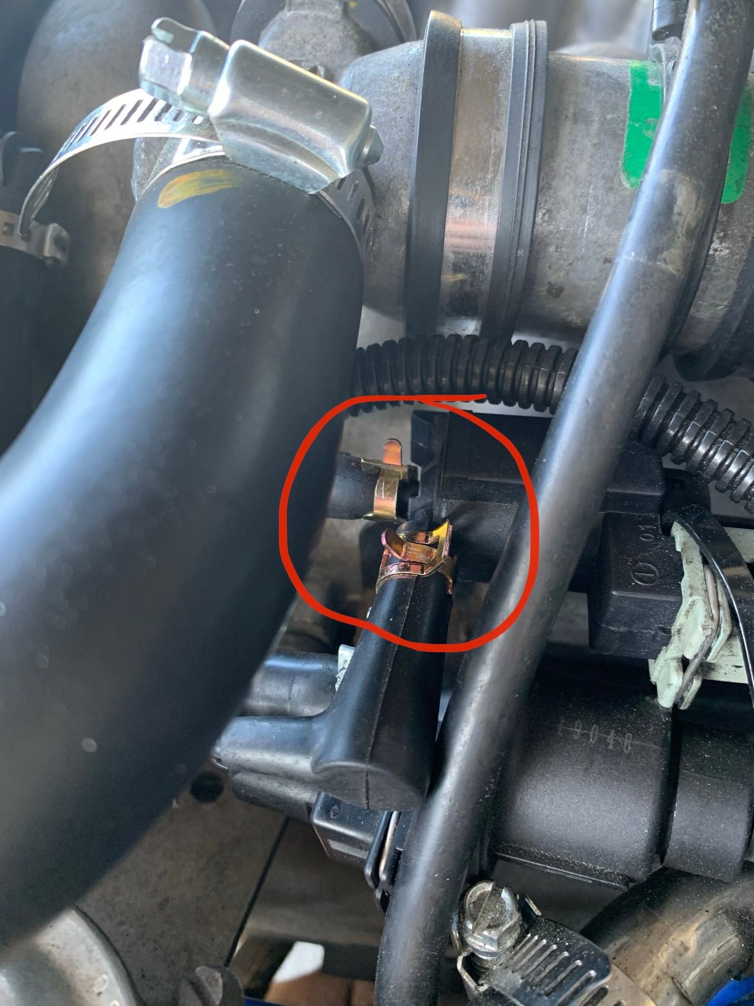

Default 2/24 Update
Truck is running great! Got a few nagging issues I am still working through. I am still fighting the P0441 error which doesn’t look like it has any impact on performance but I hate the nagging yellow light. I had already replaced the purge valve and the vacuum control solenoid and performed a smoke test but the error keeps coming back after a week. I decided to add some clamps to my vacuum tubes to see if that would help. In doing so I found that the maf hose was partially off the intake so maybe that was the issue? In any case I readjusted and tightened in and installed the clamps.
I also had some leftover DEI heat shielding so I installed that around my starter and my crank position sensor.
CKP wrap
Starter wrap

I use zip ties on those lines, mine are pretty worn and tend to come loose with a bump. like the clamps though what size are they ?
Old Feb 23, 2020 | 12:36 PM
  #250
cvhyatt's Avatar
Joined: Feb 2019
Posts: 1,222
Likes: 595
From: Jacksonville, FL
Yeah I read somewhere that zip ties don’t apply even pressure around the tubing and can prevent a good seal. I found these spring clips on amazon which should provide even pressure around the tubing.
WMYCONGCONG 155 PCS Spring Clips Silicone Vacuum Fuel Hose Line Water Pipe Air Tube Clamps Fasteners Assortment Kit 6mm 8mm 10mm 12mm 14mm 15mm 16mm 18mm 20mm 22mm
