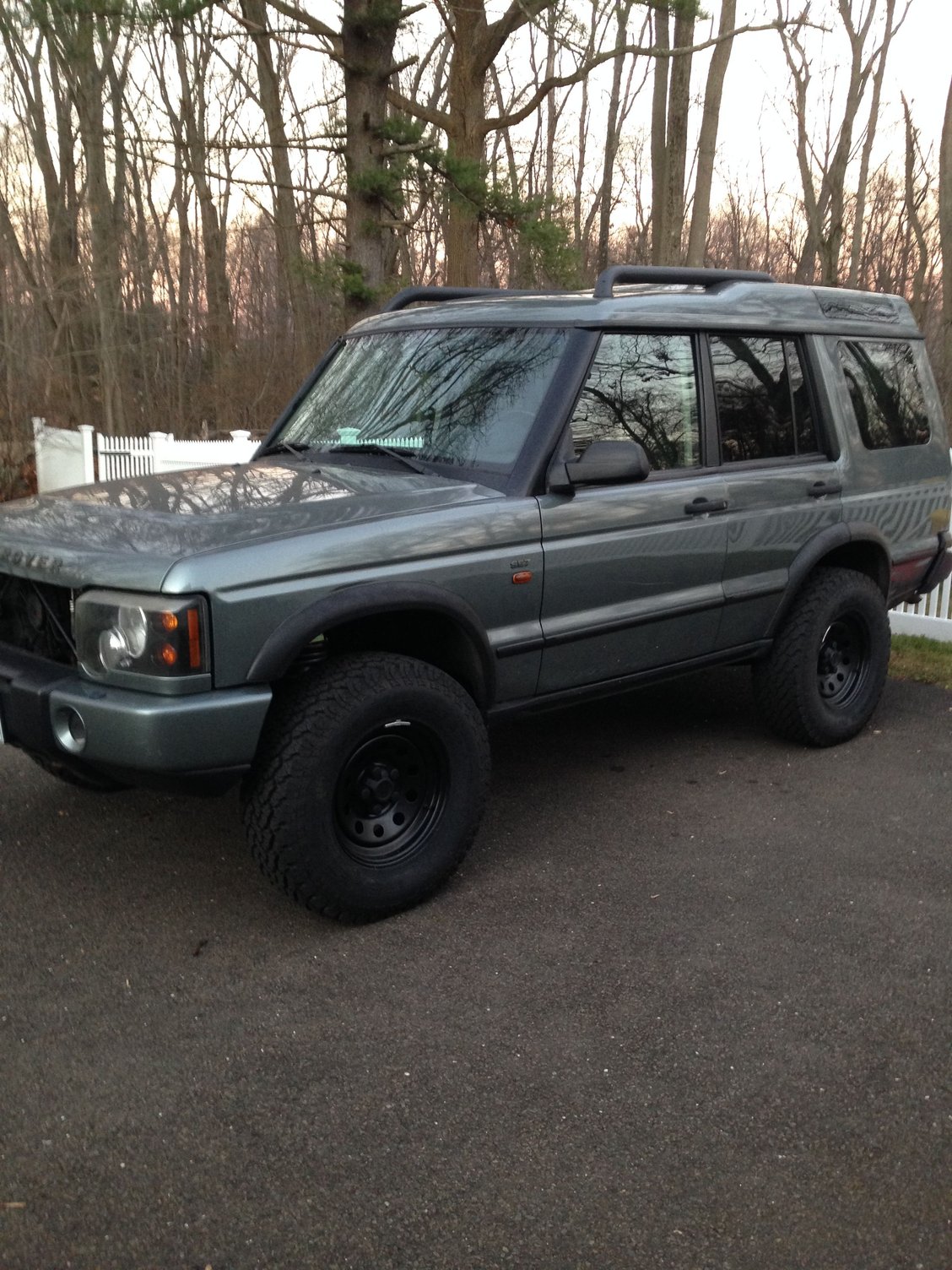

Here is a picture of the truck after my lift:
