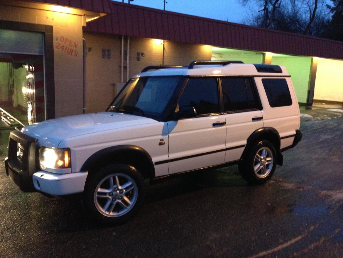

Hello! I'm new the the forums and new to Land Rovers in general so please forgive my ignorance.
I've recently purchased my first Land Rover.
It needed a few things, just thought I'd list what I've done & need to do.
Maybe some advice on the items not yet completed would be nice.
Cracked Windshield - Replaced - $150
Rear Driver Side Tail Light Cracked - Replaced - $60
Front Driver Side Fog Light Cracked - Replaced - $80
45º Front Differential Play/Slop (Replaced 3rd Member) - $217 Part / $275 Labor
Hand Brake Light Stuck On - Fixed - Added Brake Fluid
Three Amigos (Codes Read Shuttle Valves & Front Wheel Speed Sensor. (Not Replaced) They cleared the codes, and the lights haven't come back.
Rear Bumper Cracked - Not Replaced
Passenger Doors (Front & Rear) Will not unlock - Not Addressed
Belt Squealing When Cold (Only When Heater is on) - Not Addressed
I'm slowly working through all these issues, I'm going to need tires and brakes soon. (Expensive)
In the meantime, the oil looks good, but I'd like to have all the fluids done, just for preventative maintenance.
I've read SO MANY horror stories of Disco II's around 100,000 Miles and I obviously want to avoid the common head gasket issues, and everything else these trucks commonly have.
I guess I'm asking what preventative measures should I take having just bought the truck? Or common repairs that you guys recommend I have done?
I know very little about the trucks history, the CARFAX I ran was last updated at 59,000 Miles and obviously that was a while ago.
So far I absolutely adore this vehicle, I've wanted one for years, and I'd like to maintain it properly, without lining the Dealerships pockets.
Thanks!
