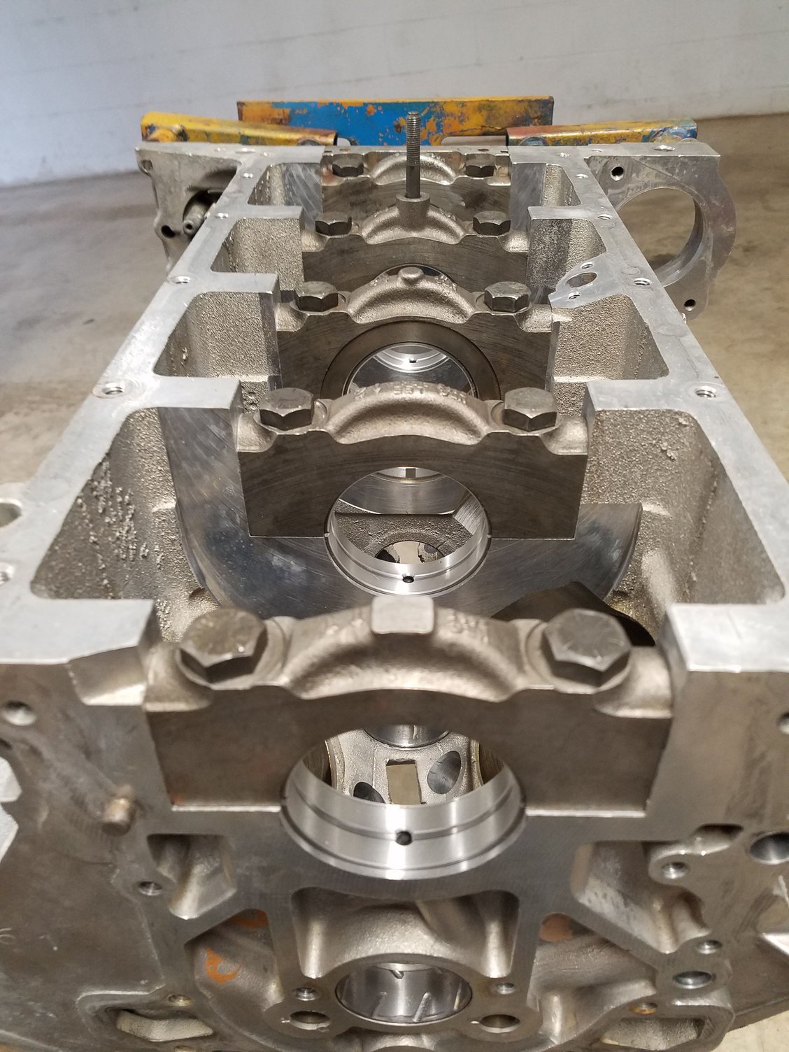

What they are talking about are crankshaft bearings, specifically the center one, and the block side half.
That bearing half has sides to it.
If you look through the 2nd main cap in this picture, you can see where the bearing on the 3rd extends over the edge of the block where it sits, as opposed to the others that are visible and do not.

So that piece that hangs over broke off into the pan as i read? Geeze what would cause that?
Old Jan 16, 2020 | 07:01 AM
Sixpack577's Avatar
Joined: Jul 2017
Posts: 3,387
Likes: 488
Yes, apparently.
I don't know the cause, other than a factory defective bearing(weak spot, etc), poor installation and assembly, or maybe it got dropped and damaged.
You could run the engine with no oil, lock it up, and that bearing should stay intact.
Who knows.
