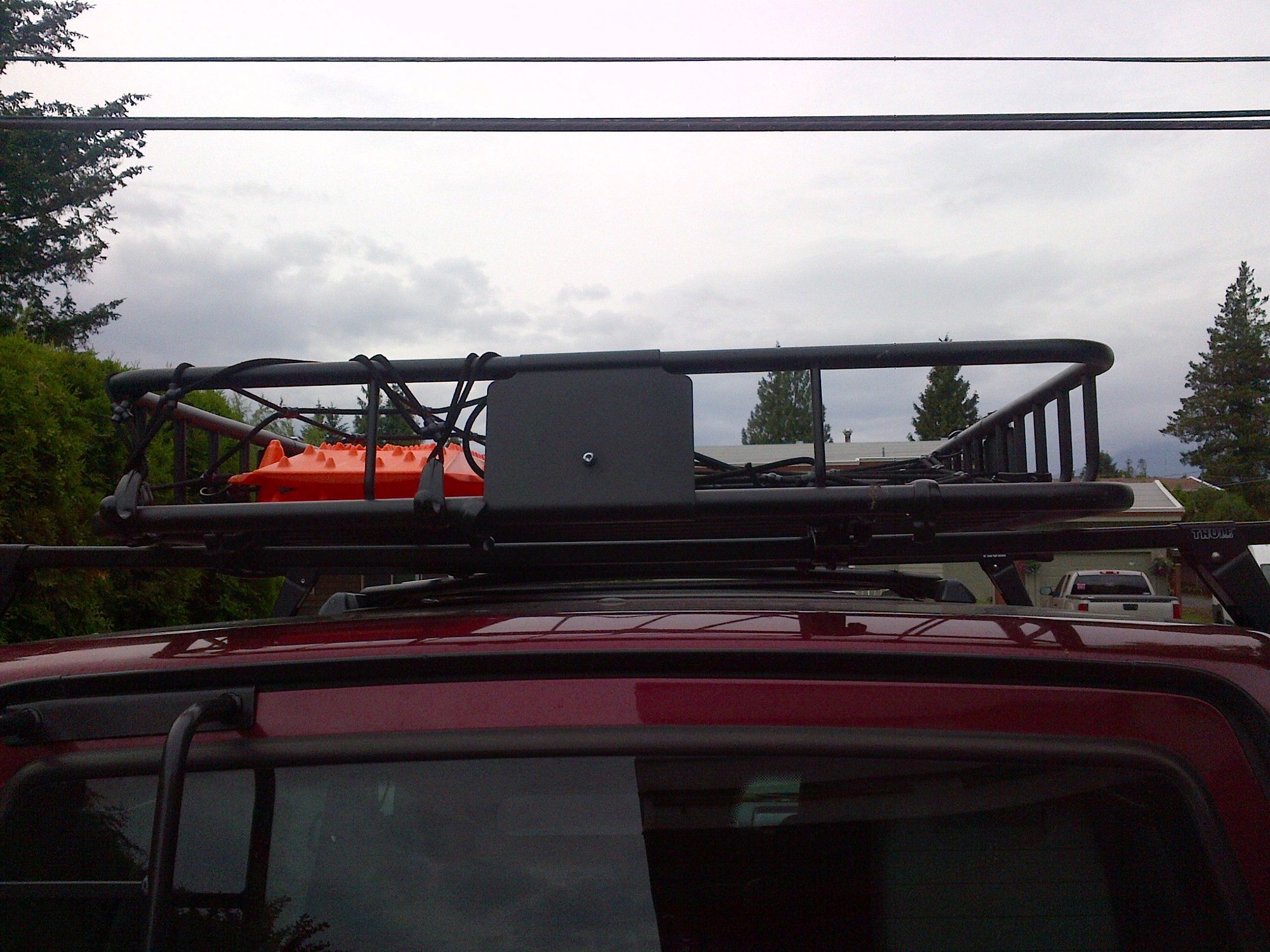

2004 cross bars (round profile) are a unicorn. One suggestion is to use the Thule 953 legs with crossbars to hold the basket. The 953 legs will provide sufficient height to still allow your sunroof to open.
