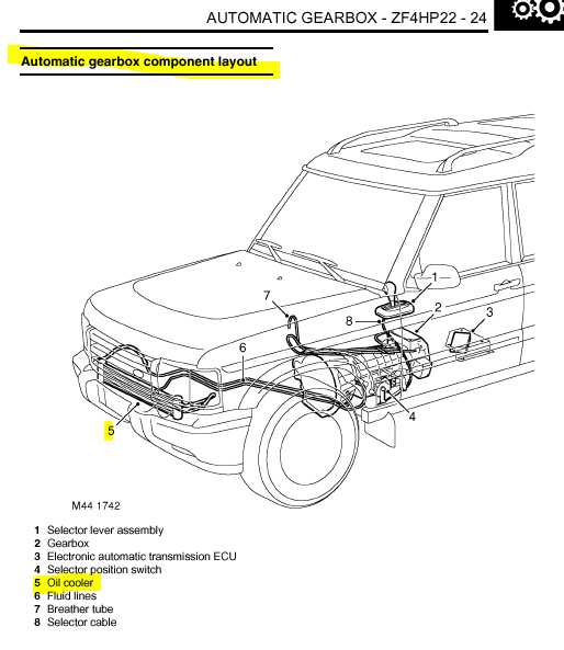

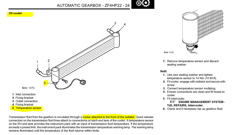

Originally Posted by twin6
Right. So my question is where is my transmission temperature sensor on the 2004 radiator?
Transmission fluid from the gearbox is circulated through a cooler attached to the front of the radiator. Quick release
connectors on the transmission fluid lines attach to connections on each end tank of the cooler. A temperature sensor
on the RH end tank provides the instrument pack with an input of transmission fluid temperature. If the temperature
exceeds a preset limit, the instrument pack illuminates the transmission temperature warning lamp. The warning lamp
remains illuminated until the temperature of the fluid returns within limits.
Same place, on cooler not radiator.
Have at it
Old Apr 8, 2017 | 03:25 PM
abran's Avatar
Posts: 6,907
Likes: 792
From: Huntington Beach CA
04 vehicles do not have a temp sensor on the trans cooler. So if your vehicle is an 04', don't hook it as there is nothing to hook to.
