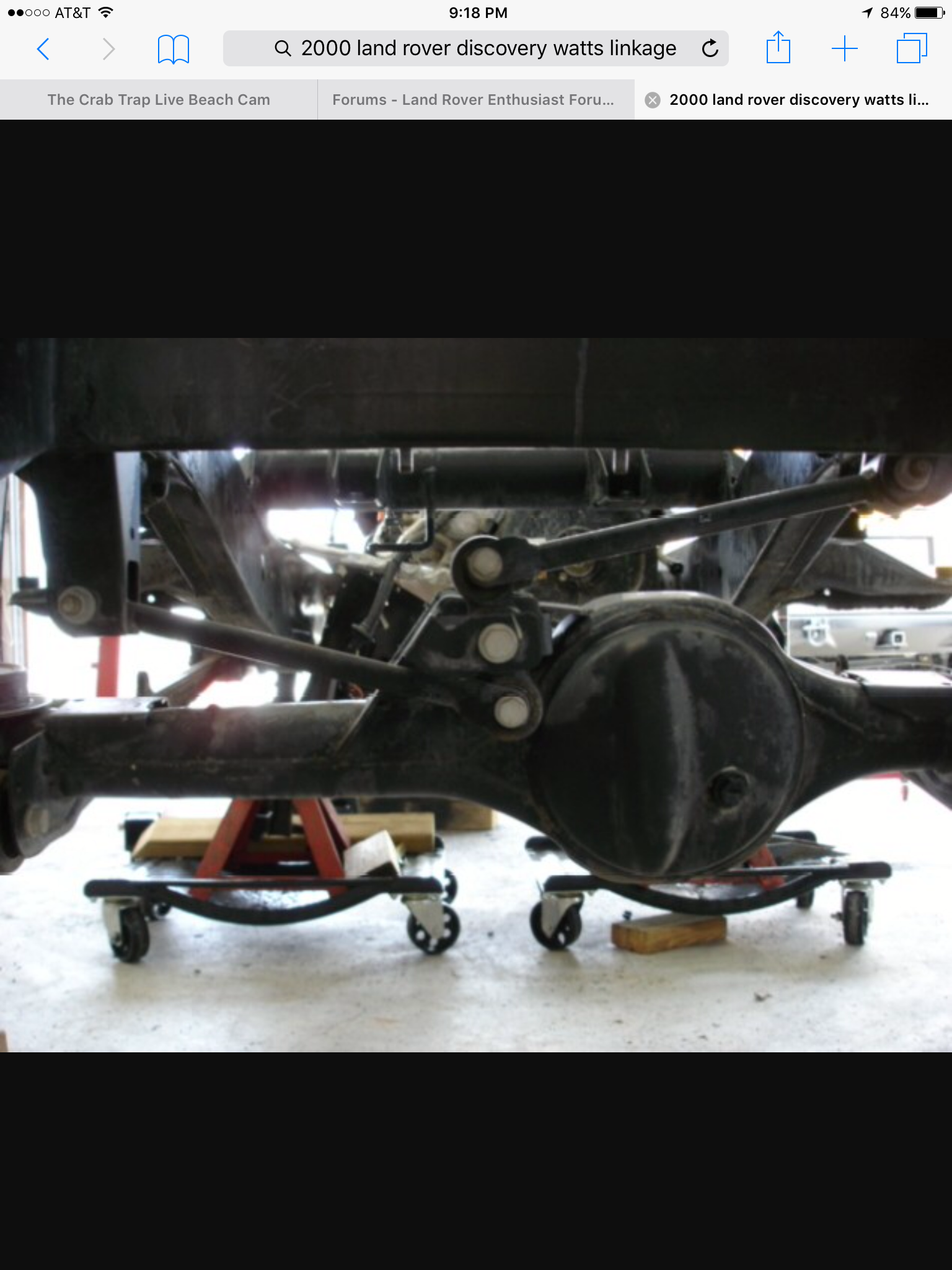

I checked the rear shocks.. I never loosened the bolts on the shocks to install the springs.. So they are tight..
But what about the Anti-sway bar in the rear? will that cause any problems with articulation or the bumping sound?
You don't have to touch them for them to be loose. Did you put a wrench on them and give the bolt a turn?
Can you replicate the noise if you rock the truck back and forth from outside? If so your Watts linkage bushings may be shot. I included a pic of the watts.

Sounds like watts linkage bushings/bearings.

I had this happening to me after I installed my lift... it was my rear shock not being torqued down correctly and it was moving around every time I rolled over a grain of sand. Tightened the bottom bolt and it went away.
