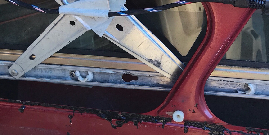

We installed the Shapeways roller today. We used a gel super glue. We decided to remove the wave washer that was part of the original installation. With it gone the fit seemed tight enough for the purpose. I was able to dry fit the roller with the wave washer still in place but it was so tight the roller didn't turn without far more force than it would ever get installed.
The plastic remnants of the webbing was far tougher to file down than expected. I think that speaks highly of whatever plastic was used.

Well, after a few months the Super Glue used to glue together the two halves of the Shapeways roller failed. My son will install another one, but do any of you have a recommendation for what to use this time instead of Super Glue?

Old Mar 8, 2018 | 12:22 AM
  #27
abran's Avatar
Posts: 6,913
Likes: 792
From: Huntington Beach CA
Rapidfuse by DAP

My Shapeways rollers are still in a bag, I ended up buying a complete regulator assembly off ebay for around 25.00. Works great.

Good to know. If the second attempt to glue a Shapeways roller doesn't hold up I'll probably go that route. At that price, in hindsight I should probably have bought a replacement regulator in the first place but this is the first instance I recall of Super Glue failing to hold a Shapeways roller together.

I would of used/tried the Shapeways rollers if my regulator gear spot welds didn't break a second time AFTER I had already welded them up once before....I was kinda tired of pulling the door panel off.
