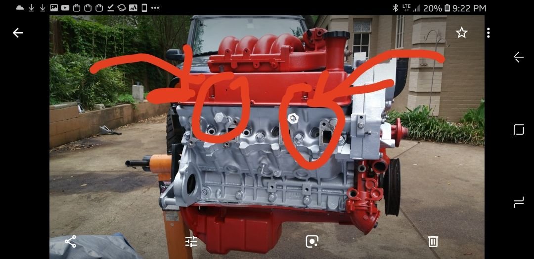

Hmm. I have never had to replace any electronics. But I have a complete extra set. Some years ago a forum member who owns a shop needed a set so I mailed them; he sent them back. I've always assumed they were a matched set and the BCU and ECU had to be swapped together.
I know my input on this thread is opposite of what you need to know because you are going the other direction than I went, presumably because the 4.0 is generally accepted to be more reliable. But I did not mess with the immobilizer or swap any electronics at all. And I swapped back to the 4.0. I think your original stuff is good (with the small exception of an ECU that expects ridiculous SAI components).
My original truck is non SAI. The 4.6 I rebuilt and destroyed was from an SAI truck. I just plugged the SAI holes with chopped and filled SAI lines....
you should be able to do the reverse of necessary...
