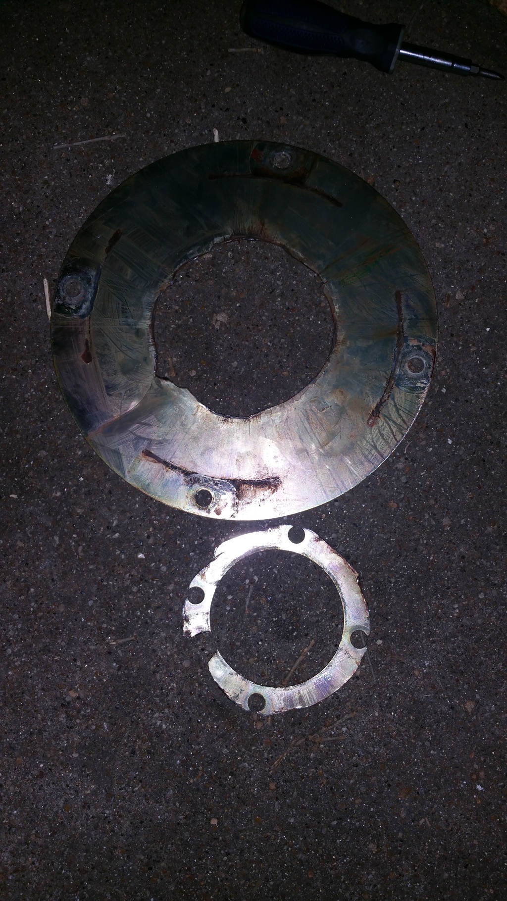

I was removing the bolts for the flex plate spacer ring in poor light and picked what I thought was dirt off of the flex plate. With my FINGERNAIL. It made what sounded like a metallic clink when it hit the ground. So I took the ring and flex plate off and walked with it toward the light and the center of the flex plate fell out. Seriously... Fell out with the slightest pressure. I then saw that it was cracked in a circle around the spacer and toward one side and the crack was dirty. Not new. A definite show stopper and I would normally be dismayed, angry, sad, grief stricken, and any other combination of emotions but wow, that could have really stranded me big time. I'm actually happy at the timing. And it would have required transmission removal when I'm not already doing the engine. I googled it and others have had the same issue. Check this out:
More overnight shipping
EDIT: While that particular flex plate is 16 years old I clearly remember it being pristine when I installed it a few months ago. Further research yielded speculation that damage similar to that could be caused by overtightening the bolts in the retainer ring. That makes sense I guess due to the circular pattern of damage (right where the boundary of the retainer ring goes). But I think this was caused by stress on the drivetrain due to my bent rod. I tighten these on the crane, because the back of the engine is concealed on the stand. You can't tighten very much on the crane. The rave gives conflicting torque (33 and 37 ft/lbs) so I went for 35. That's not very much torque but it is almost the point when a free engine will start to turn with the spark plug holes open.

Woah, that's insane Charlie. Just fell out like that. D*mn.
Well like you said, better now than a week from now.

That particular part was 16 years old so... Dang I still can't believe it. I don't now how I made it to Sams Club this morning. Unless I'm missing something, that flex plate makes the truck go.

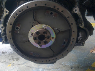

you have all the fun, but your not the only one
Attached Thumbnails 4.6/hp24 into 4.0/hp22-030120131835-1-.jpg
Yikes. That's bad. My new one arrives tomorrow for a mere 81 dollars with shipping. Shipping is a racket. I can Fly to Las Vegas for less.
