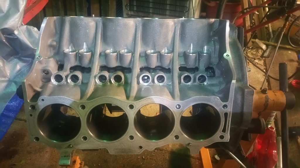

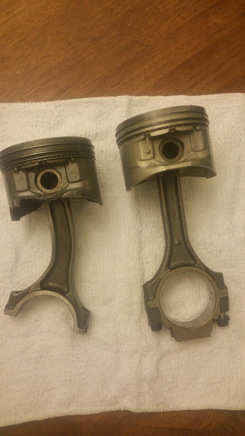

Thanks for the encouragement. I am at the piston choosing stage. Here is where I am.

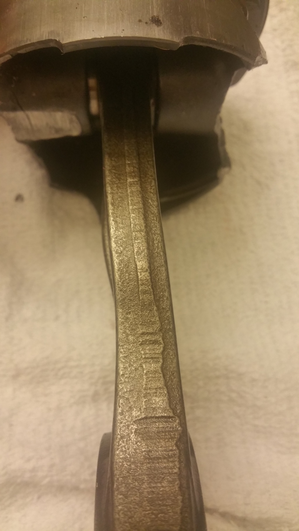

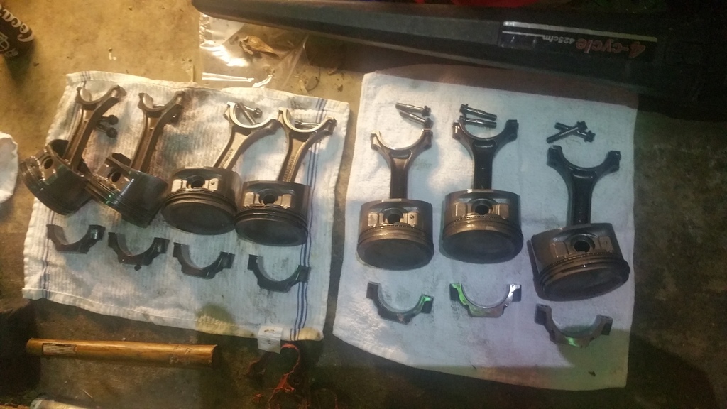

Default Bent conrod
You guys are right. No way I could have done this manually... I couldn't do this with a sledge hammer:
Will be sitting on the fence before sending mine to you for a rebuild. Kidding aside, something out of the ordinary happened and not likely to occur again. Hope all goes good and looking forward to that news.
