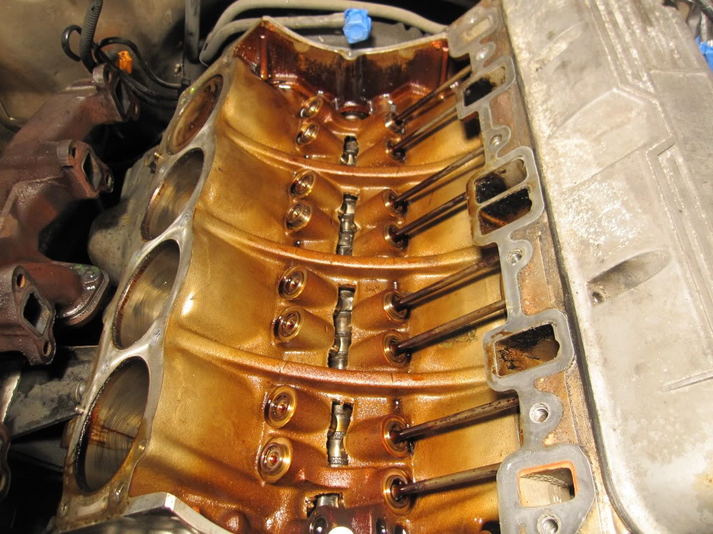

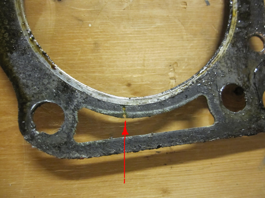

Well I pulled the drivers side head to see what I could find. And - Good news! - blown head gasket, not a dropped sleeve.

Notice the oblong shape "kink" in the gasket along the coolant jacket.

A closer look reveals that the gasket is compromised.

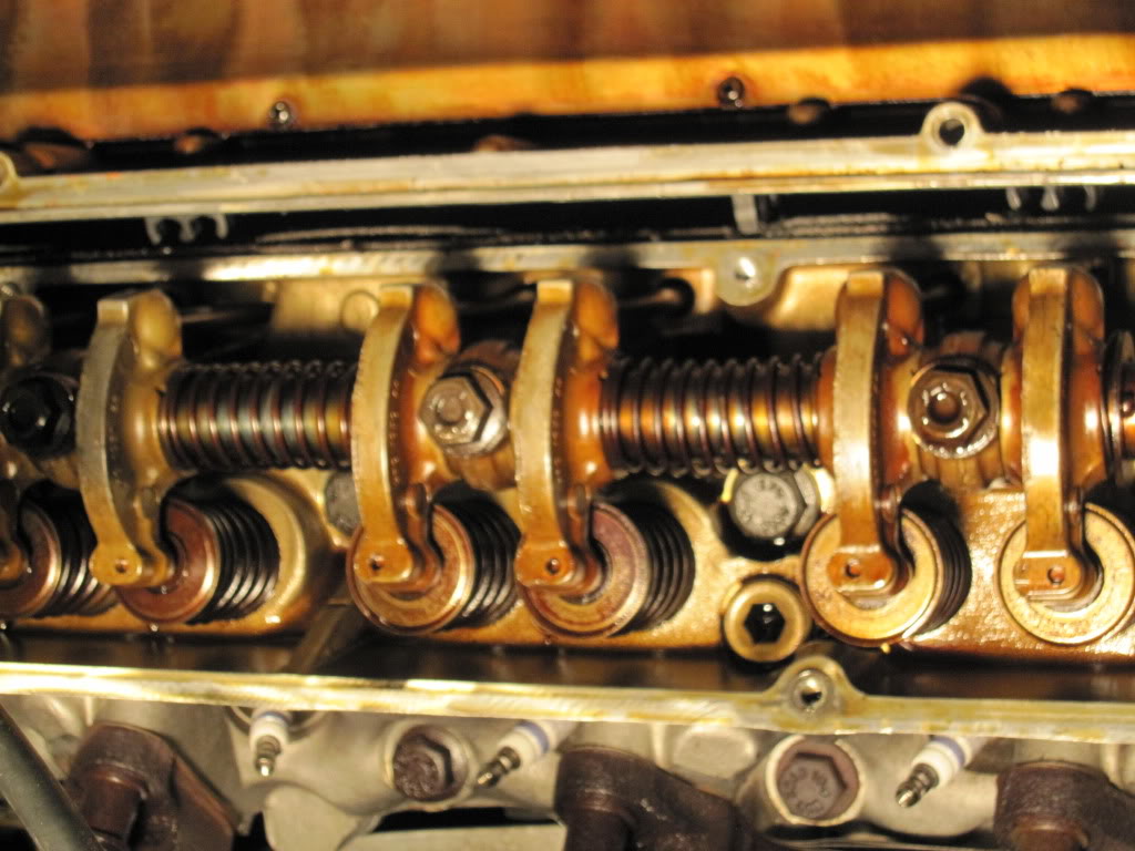

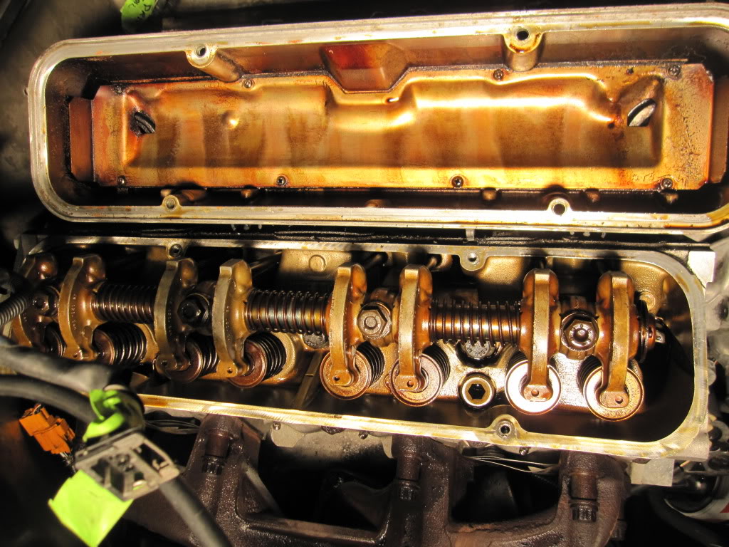

Take a look at my valve cover / rocker assembly. This is with 231,000 miles and usiong Moble 1 synthetic and K&N filter for the entire life of the motor. I am convinced that once I clean this up and change the O2 sensors I will get another 75K miles.

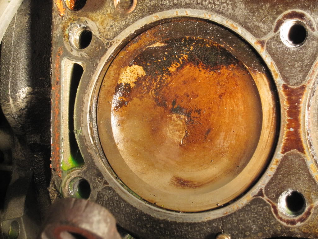

I checked the ridge at the top of the cylinders and I was very suprised to find very little wear in the cylinder walls.
