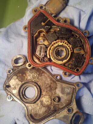

The H pattern is on the models with a CDL, which is D1s and later D2s. Some early D2s have a spud on the transfer case that can be turned with a wrench to invoke locked CDL. If you have a blown diff, normally that drive shaft turns, and the wheels don't.
These trannys are electronic, and there is a switch on the side called the XYZ switch. It tells the electronics where you put the shifter, so they can work the valve solenoids. The XYZ can get full of mud. Can remove, cleanout, re-seal. Can also test contacts with a meter.
The factory shop manual is called the RAVE, links below, don't pick up a wrench without it. HAs electrical manual and circuit diagram as well.
