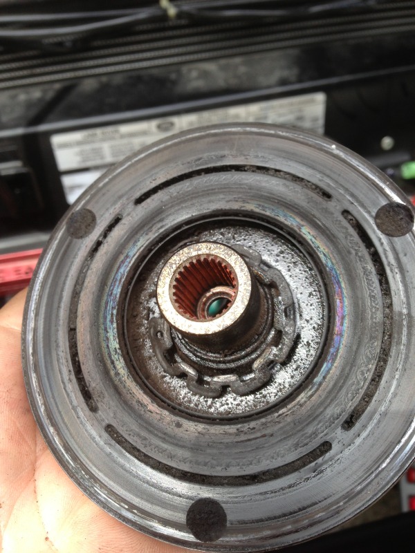

I'm thinking about ordering a new clutch bearing because its only 20 bucks. If that's the problem simple fix. If not then I'm gonna have to have someone swap one for me. I think you need special tools to properly remove the Freon in the system and then re charge it. I'm thinking of just paying a little extra and getting a new Denso. There is a parts guy who can get it for me for 280 after tax etc. Might be worth it.

UPDATE!!
Took the AC compressor pully off and found this under!

Looks like I'm missing a few ball bearings + destroyed the clutch.
But the splined rod spun freely so I think the compressor is OK. I ordered a rebuilt kit and should have it in a couple days. Cross your fingers this fixes it.
