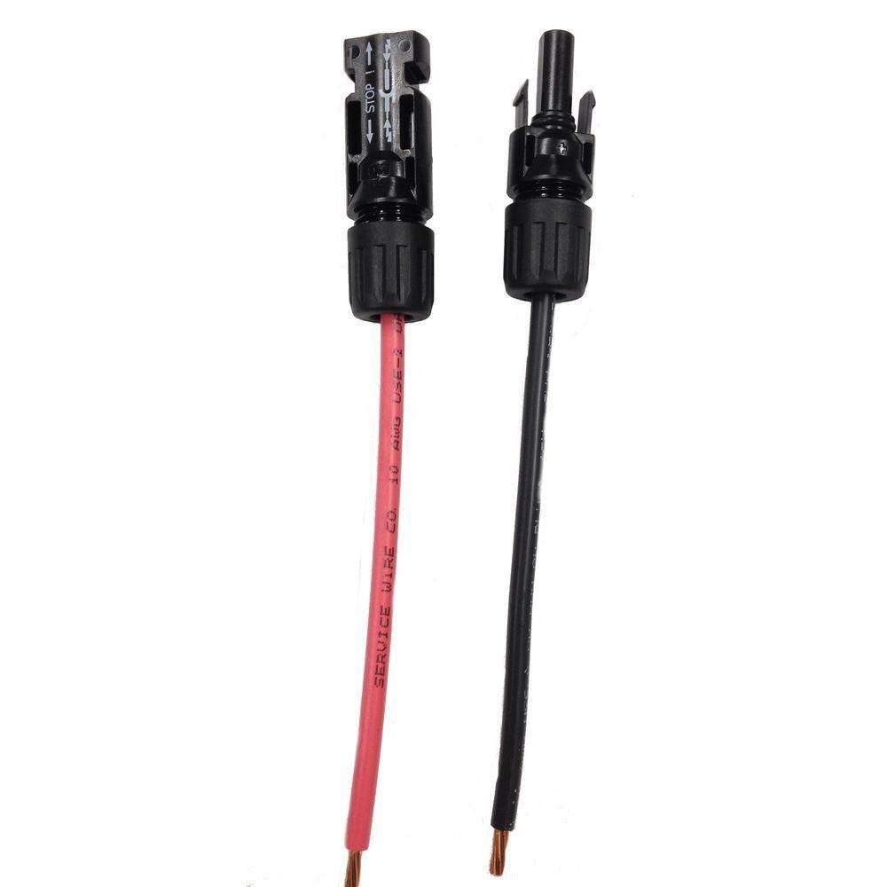

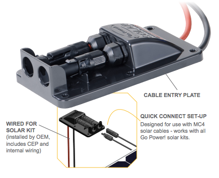

If you have your liner out, I guess you can use this waterproof roof wiring hardware for RV trucks.
I'll have to see if I can find this thing at a parts store
