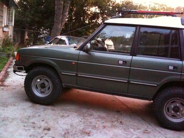

My '98 has OME medium duty 2" springs and BFG M/T at 235/85/16 mounted on steelies.
The attached pic shows some articulation, as she was parked funny. The only mods needed to fit the tires were a bit of fender trimming on the rear. Follow the writeup on discoweb and you'll do fine.
Oh, and the difference from factory rubber to the M/T's was amazing. She oozes trail prowess now, and lowly jeeps and chevy's shudder in her presence.

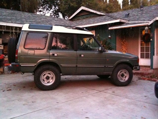

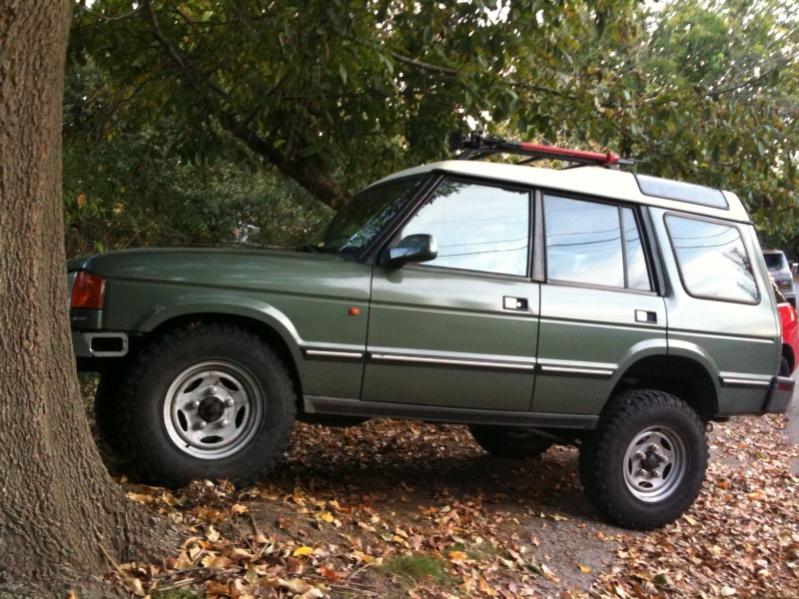

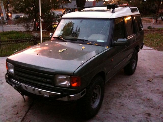

Hey tweak, just traded the BFG's for some Goodyear MT/R's. Still the same size at 235/85/16. I love these tires. The BFG's tried to vibrate my teeth out of my skull when I'd drive on the motorway, while the goodyears are as smooth and quiet as the factory suv tires.

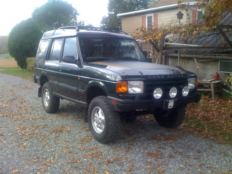

This is my 1999 D1 im running Toddco 3" medium duty lift with Pro Comp ES9000 shocks. 245/75/19 M/Ts without any fender trimming or any rubbing. i can easily fit 33/12.50s but needs fender trimming

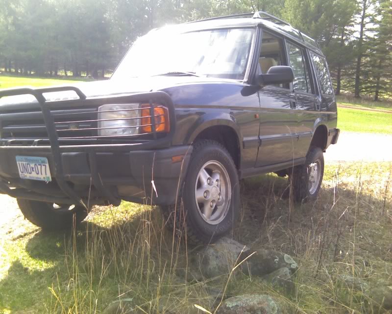

super gaz 1.5 lift, all the rest stock. I think the only thing that would rub if I put bigger tires on would be the plastic on the front air dam. Which is getting hacked off come spring.
