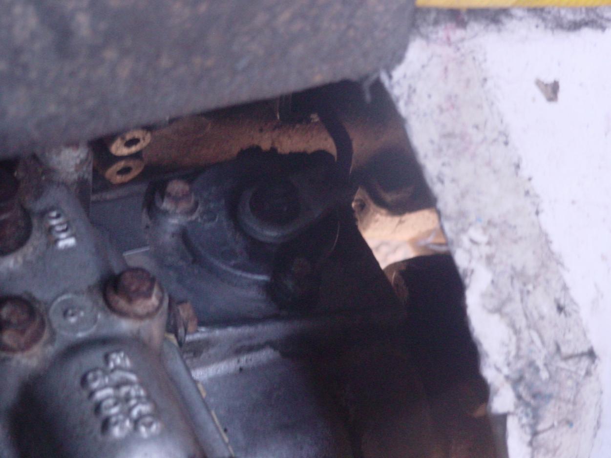

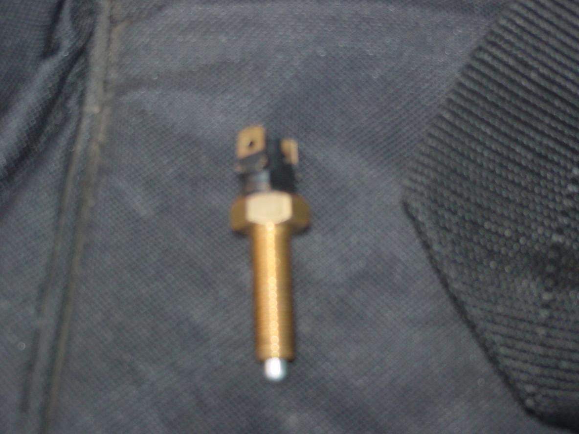

I don't know who this guy is you got doing your diagnosis, but I think he is fukking you bad. The linkages for shifting the transfer case from high to low and for engaing and disengaging the Center Diff Lock are pretty simple mechanical linkages. The biggest problem in correcting a problem with either is the accessability. You have to remove the center console completely to get to everything.
Mine was completely frozen when I bought my 97 Disco. That was the first repair I did on my Disco. There is a lot of info on DiscoWeb.com on how to accomplish it. There are a few little pieces (clevis pins and spring clips) that I ended up buying all those little pieces from Rovers North for just a few bucks. With some simple dissassembly you can replace the little devils and relube the shift mechanism and linkages. I also had to replace the electrical switch that has a spring loaded plunger that turns on the CDL engaged light and completes the circuit involved with the CDL engagement.
Download trhe RAVE manual, it is all detailed in there. Here's a few pics of mine.
Don't trust your vehicle to anyone who "forces" something to work and tells you to look for a replacement.
