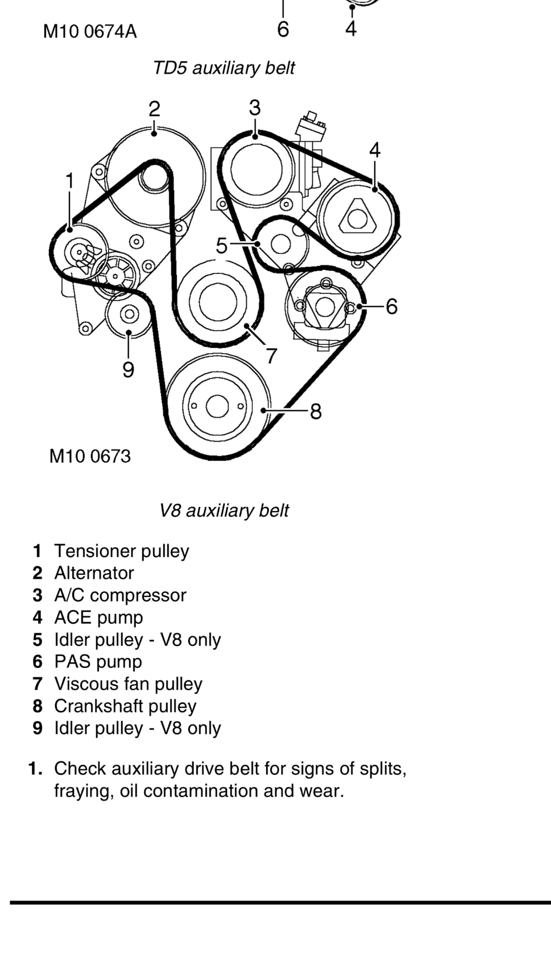

You could have an air pocket but just remove the coolant tank from the housing and lift it up and bleed it that way. The other option is, did you route the belt properly? If not , it will try to push water out instead of take it in. Just my thoughts
Old Dec 31, 2016 | 07:30 PM
Luckyjayb's Avatar
Joined: Nov 2016
Posts: 1,611
Likes: 112
From: Bham, Alabama
Here is the belt routing diagram
Of course number 7 in the diagram is the water pump/viscous fan. Check your belt routing and then re bleed the system
