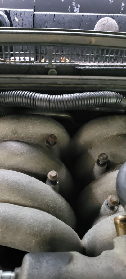

So, I started the coil relocation. I have a couple of questions now that I'm into it.
1. My truck is SAI. Does the portion of the instructions regarding SAI apply to both side of the engine?
2. I think whomever worked on the coils last didn't install any of the mounting hardware. I can move the bracket around. Is that common for shops to do?
3. Are these the only bolts holding the intake on?
if so, should it lift right off? If prying is required where should it be done?
Thanks
Erik

There are two more bolts, one at the front and one at the firewall. In addition there are two screws that mount the SAI pipe to the upper manifold, you need to take them off.

As Discorama said, total of 6 bolts, 4 in the center and two shorter ones front and rear in the center (btw, I never put those back in). To answer your questions, yes very common for shops to not put the bolts back in to the mounting bracket. Hopefully they did not put the bolts in to the sai bracket either, can you wiggle the pipes? On the sides, yes the manifold brackets are basically the same left and right, from the factory they are mounted to the upper intake with studs and nuts. Those are often left off after the first coil replacement too.

Your insight about the SAI bolts are correct. I can move the tubes behind the motor.
Ill check on the passenger side bracket to see why that one seems more difficult to get free. Thanks for all the work on this kit.
