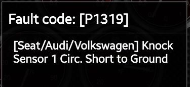

After the coil swap this weekend, P1319 appeared along P0305 as logged faults after driving 2 blocks and able to step on the gas. I cleared them on Monday morning when driving to work, and they both re-appeared a few blocks after driving. This is what P1319 shows on Torque app...

But this morning I noticed new codes as logged: P0301, P0306 & P1300, which Torque describes as...

I still think you have coil and wire issues. But not on 5. You might have pinched a wire doing the intake giving you the P1319 code. Have you downloaded the RAVE? You need the P1319 code specific to LR. It either is a short or an open, we need to know which.

...truth be told, few of the wires have some smoky white marks in certain areas, kinda like if a short or something burnt them, besides that, they were all well connected to the coil and seemed not broken or damaged. Coil still looks fairly new. As per putting back the intake, I had my doubts putting it back on, since it gave me more trouble than usual, so you might be right. I will definitely get back to it and will replace the gasket, it looks beat up already. As per the code, yes I have the RAVE and it describes it as "Misfire detected with low fuel level". The loss of power is noticeable after last step, the coil swap. I was thinking about getting new set of plugs, and might as well get a new set of wires just in case. When you say "not on 5", is because you still think that cylinder does have some other issue, right? Let me know, thanks.

The knock sensors on D2's almost never go bad, I have never had a bad one nor have I ever read about a bad one on here. I have had bad, damaged, deteriorate knock sensor wiring. The 1319 is a short and that wire is in the loom that runs along the PS lower intake injectors, you could have pinched or damaged that wire during the upper intake removal.
Ignore the P1300, it is irrelevant. It is merely a multiple misfire code.
Please bring CEL code definitions from the Rave manual, not the torque app. This is LR forum and we need the LR definition, not generic or multiple manufacturer codes.

As per the "RAVE", P1319 is defined as "Misfire detected with low fuel level", but not sure what that means.

If 1319 is the low fuel misfire code then I would ignore it. Fix the misfire and it will go away.
