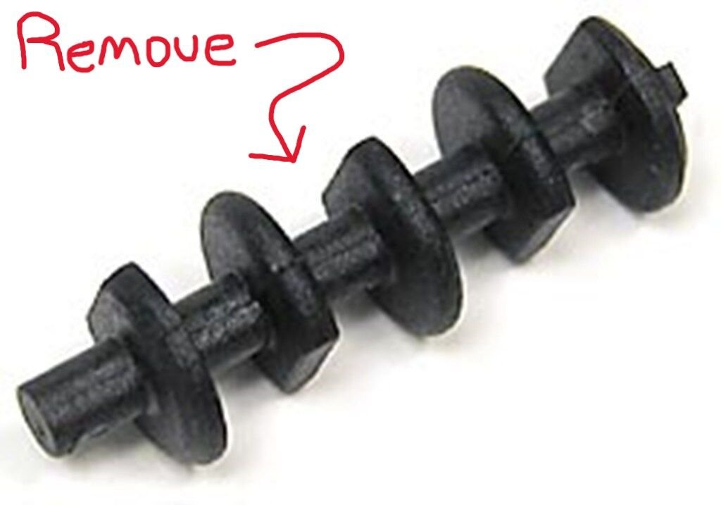

But thinking a bit more, he probably means the plastic baffling piece that fits in the hole in the valve cover. That needs to be removed when you add the PCV valve.

Valve Cover Side = Should be open hole with no OEM plastic baffle
Intake Side = V288/FV308 PCV
If you install the V288/FV308 PCV and leave the OEM plastic baffle in the valve cover you are totally defeating the purpose of the upgraded PCV because the OEM baffle in the valve cover will clog and then crankcase pressure will build up causing oil leaks.
... correct, this issue came up after I pointed out how dirty it was around valve covers and 4 closest intakes to front. I need some looking to do when I go back to swap coils and keep troubleshooting P0305 code, which is the more pressing issue now. Thanks for your feedback, greatly appreciated.

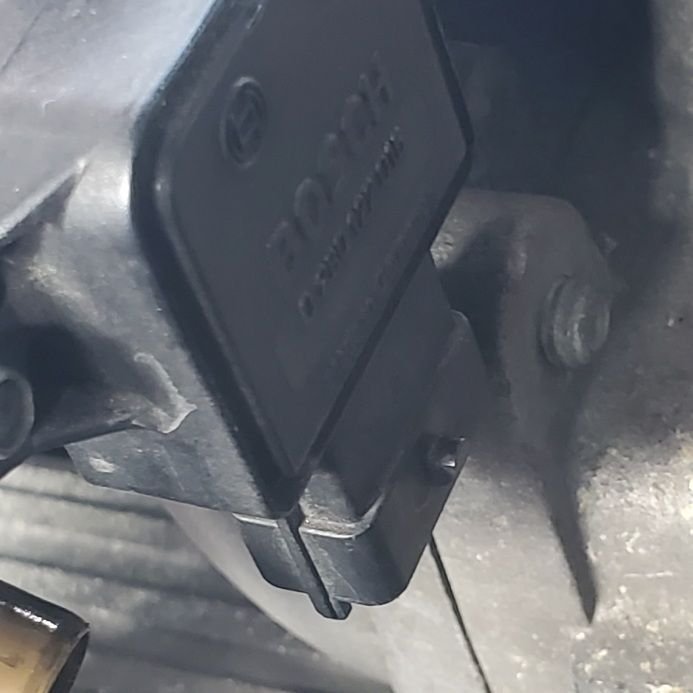

A couple issues did surface along the way though: broke the tab in one of the connectors as I was removing it, hopefully it will hold in place without it (see pics below)...
Connector with broken tab.
Where connector plugs in to.

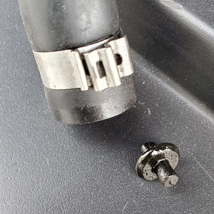

Additionally confirmed that the "plastic baffle" was still in place, but when removing the hose to check, the tip of the baffle broke off. Also, metal nipple on other end definitely is not the one that BEST4x4 suggests, so I'll deal with this MOD at later date. See pics below...
Broken tip of plastic baffle.
