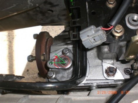

X2 on cooling system and the front shaft. Also be aware that heat gauge is not accurate, it will point at 50% from about 130 - 240F. One mod is a $69 Ultra Gauge, which displays live data from the OBDII port, plus reads and resets codes. Pix of two trucks, two temps, same gauge reading. Also pix of the stub that you shift to make locking CDL. You may just have to add the shift linkage kit.

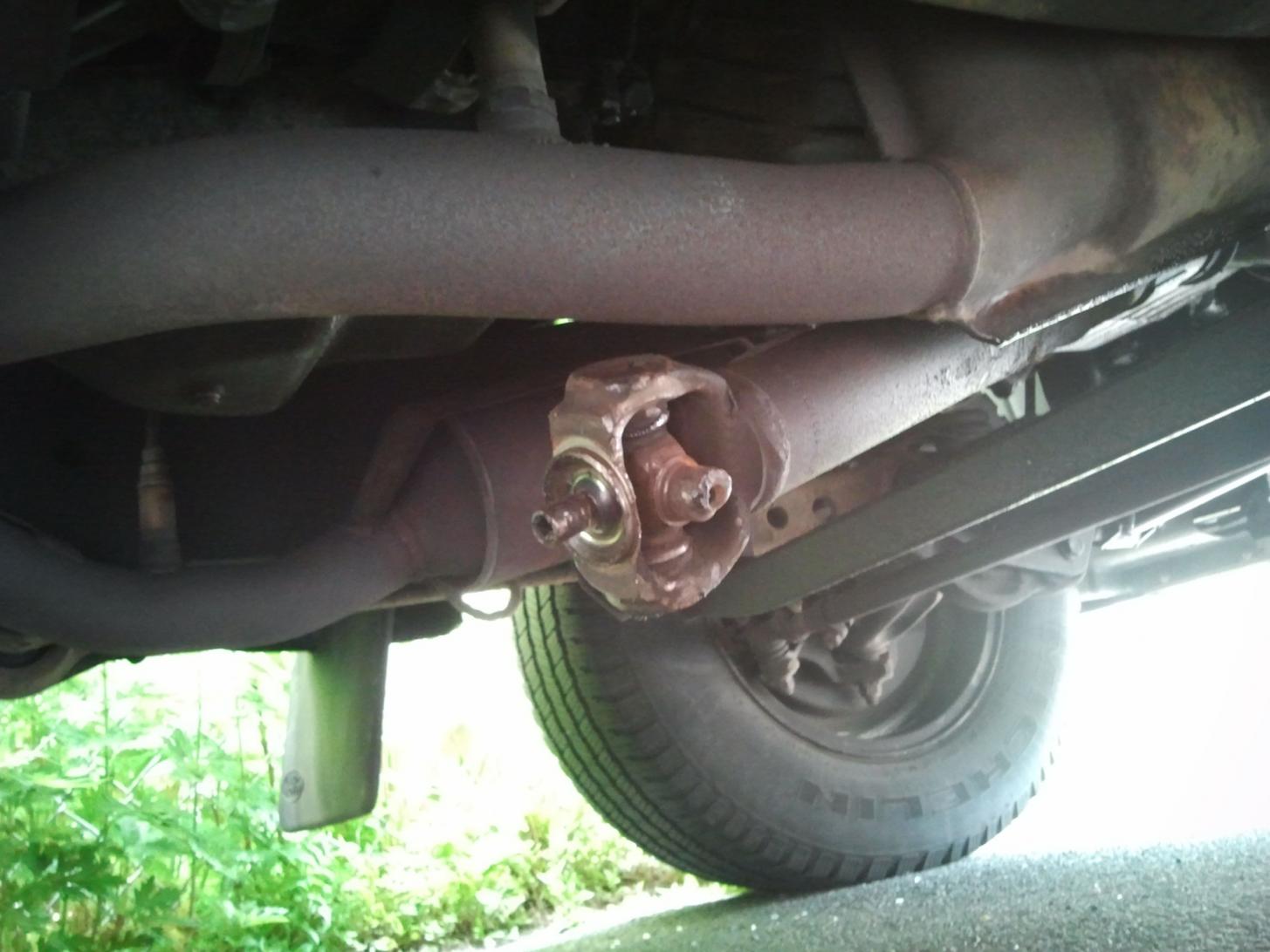

Might want to have you and your Dad to read my major service list at the top of the D2 section and do it all especially the front drive shaft inspection/rebuild or replacement based on if the 3 front u-joints each have a grease fitting.

Next, the drive shaft. It's sealed, the grease will burn up, and anywhere from 80-130k it will suddenly explode taking the transmission with it. That's another $2-4k in damage that could have been prevented with a $300 part. My Disco II had 99k miles on it, when I pulled it and compared it to the new GBR unit, you could tell the grease in the center ball was going (u-joints seemed fine). I probably had 10-15k left in it.
