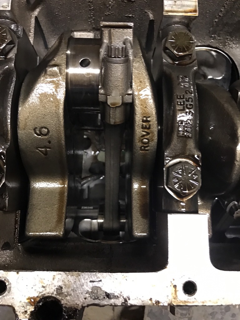

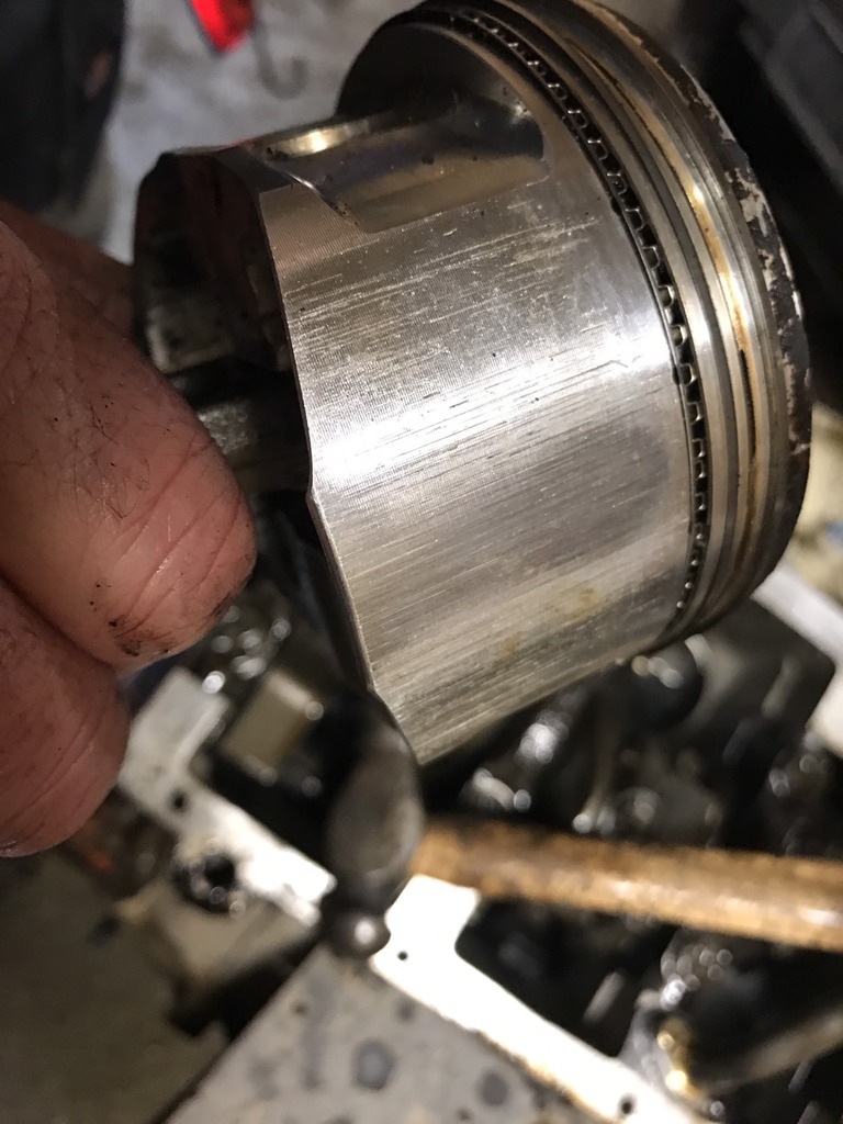

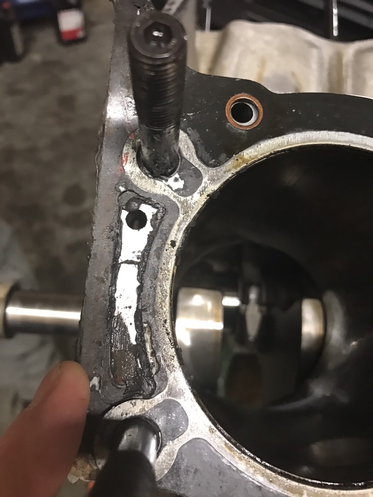

Different Cannibal Motor but more pics of their quality work. This one knocked from day one and had oil pressure issues. Cannibal did not stand behind their product in any way. The knocking was the pistons smacking off the top hat liners. Wrist pins were bound up and the final insult to injury on this 5.0 Performance build? Standard 4.6 parts all the way through.... No grind to the crank and stock rods, pistons appear to be aftermarket stock replacement. Still digging on that.
