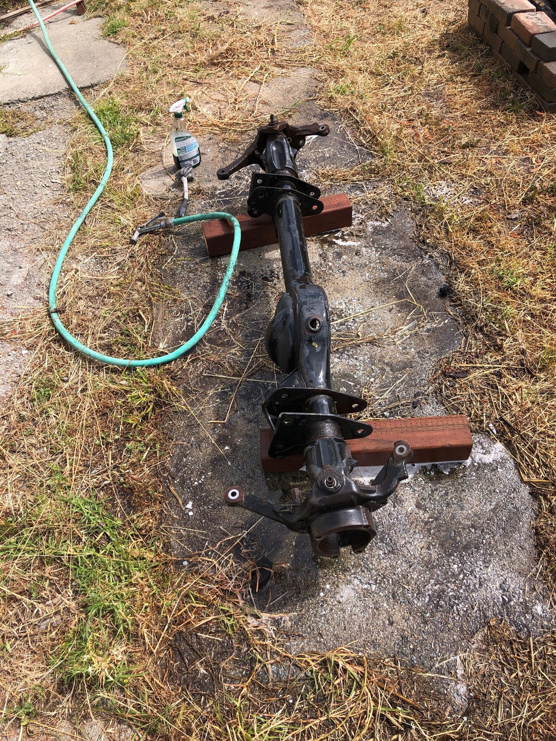

Hey all! Well, what started as a simple differential replacement has now spiraled over the last few days into an entire front-end redo. I have new bushings, steering rods, shocks, springs, and hubs going in. I'm de-rusting and painting along the way too. So, while I have everything apart, what else should I be doing? I already plan on replacing the oil pan gasket. There's a leak coming from somewhere and it looks like it's coming from there. Super simple to replace it with nothing in the way. Anything else? I noticed the power steering hoses that run in front of the radiator are super caked with rust. The PS hoses aren't leaking though. So any reason to replace?
Also, fun find at the junkyard the other day... I went there to fetch a bunch of non-rusted fasteners and bits to replace all the rusty bits on this one (began it's life in PA, what little time salt takes to make a mess) and the disco at the junkyard had nearly new terrafirma steering and panhard rods on it! Got all three for $40. What a deal!
