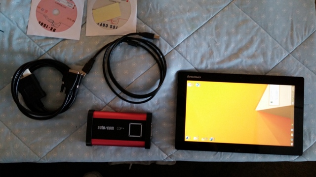

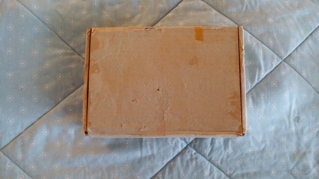

The box it was shipped in minus the wrapper. I forgot to take photos at first.
What's inside.
All laid out. The decal was NOT installed??? I had to take the end cap off to install it because it would not slide under the caps. If you get one, you'll see what I mean.

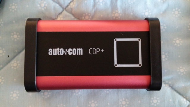

Decal Installed and looking pretty. VERY well built, inside and out. Aluminum Casing. The square with holes are lights that light up different colors depending on what it's currently doing.
Ready for Software Install on my Tablet. OH, the Software Install!!! Yuk!!!

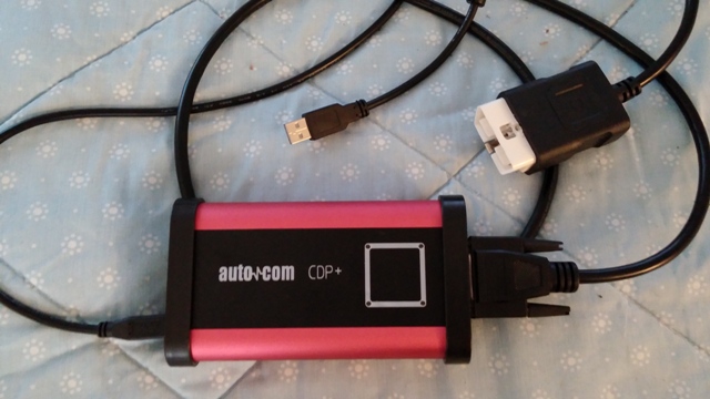

Cables Connected:
Handy Dandy LED to help find the OBD Plug under dash:
Plugged in and Lit Up Ready to Read Codes or???

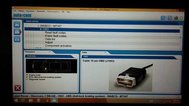

Linked to Software.
Some options on ABS.

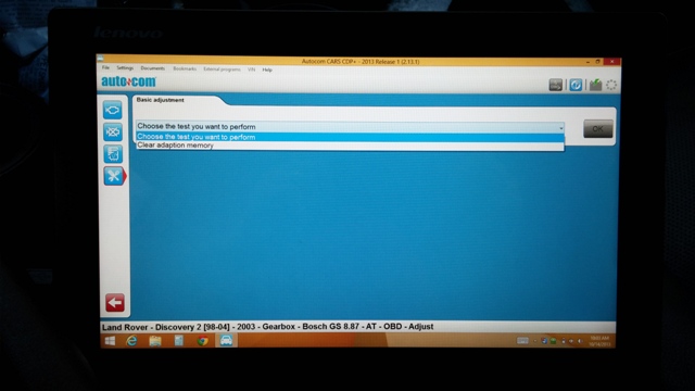

Clear Transmission Adaptations.
