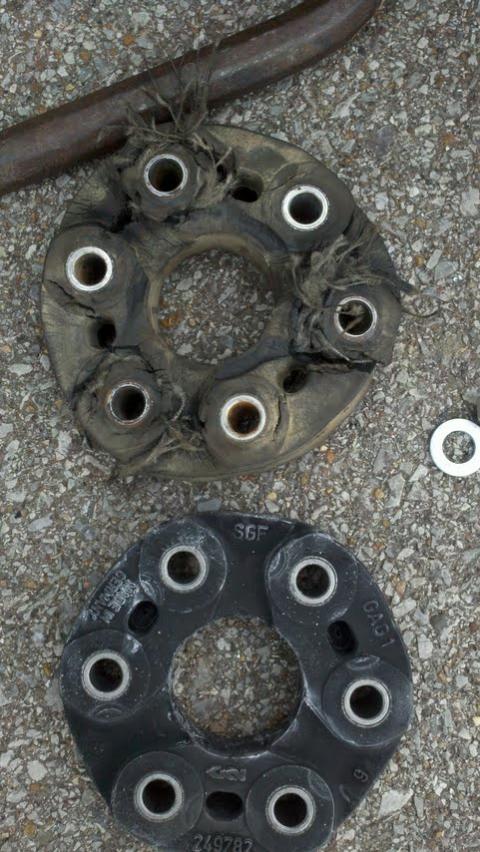

Check the rear flex coupler for the wierd noises.
Little help with the location of the rear flex coupler?
Old Mar 31, 2013 | 04:15 PM
MC04DII's Avatar
Joined: Oct 2012
Posts: 468
From: Birmingham, AL
Where the rear u-joint on the rear driveshaft would normally be. So right in the front of the rear pumpkin. They used this as a vibration damper over a common U-joint, ironically when it starts to fail it causes much vibration.
