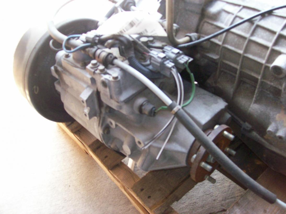

Here's a tranny for cheap. I know the listing says transfer case, but it's actually the tranny plus the transfer case. They don't know **** from shinola...
http://cgi.ebay.com/ebaymotors/00-01...item19bd88e910
