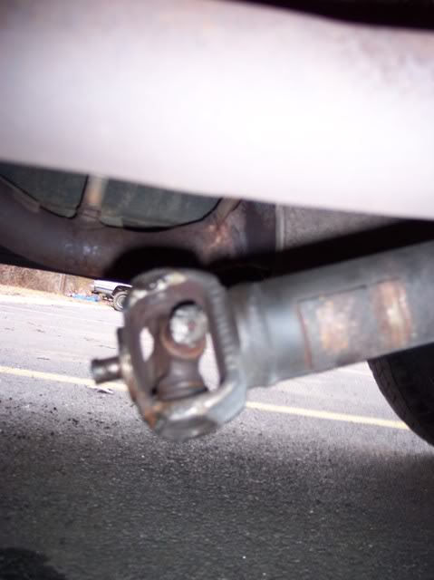

Trust them, they know what they are talking about. Otherwise, this can happen:

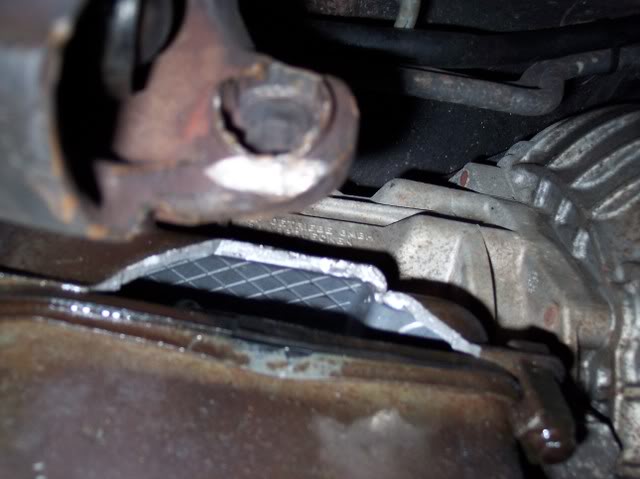

And when that happens, this can happen:
In case you were wondering, that's an enormous hole in the side of my transmission.
No, it didn't happen to me, I bought it cheap because this happened.

Tornado-keep those pics handy, anytime somebody posts a question about the double cardon it will be your job to post these pics so they can see first hand what can happen.
Spike, I got 'em saved right in my photobucket account for just such occasions. I aim for the shock factor...the thing that makes them yell "Holy ****!"
