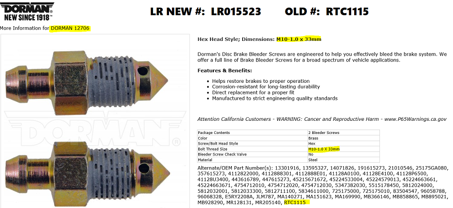

DORMAN 12706 fit.

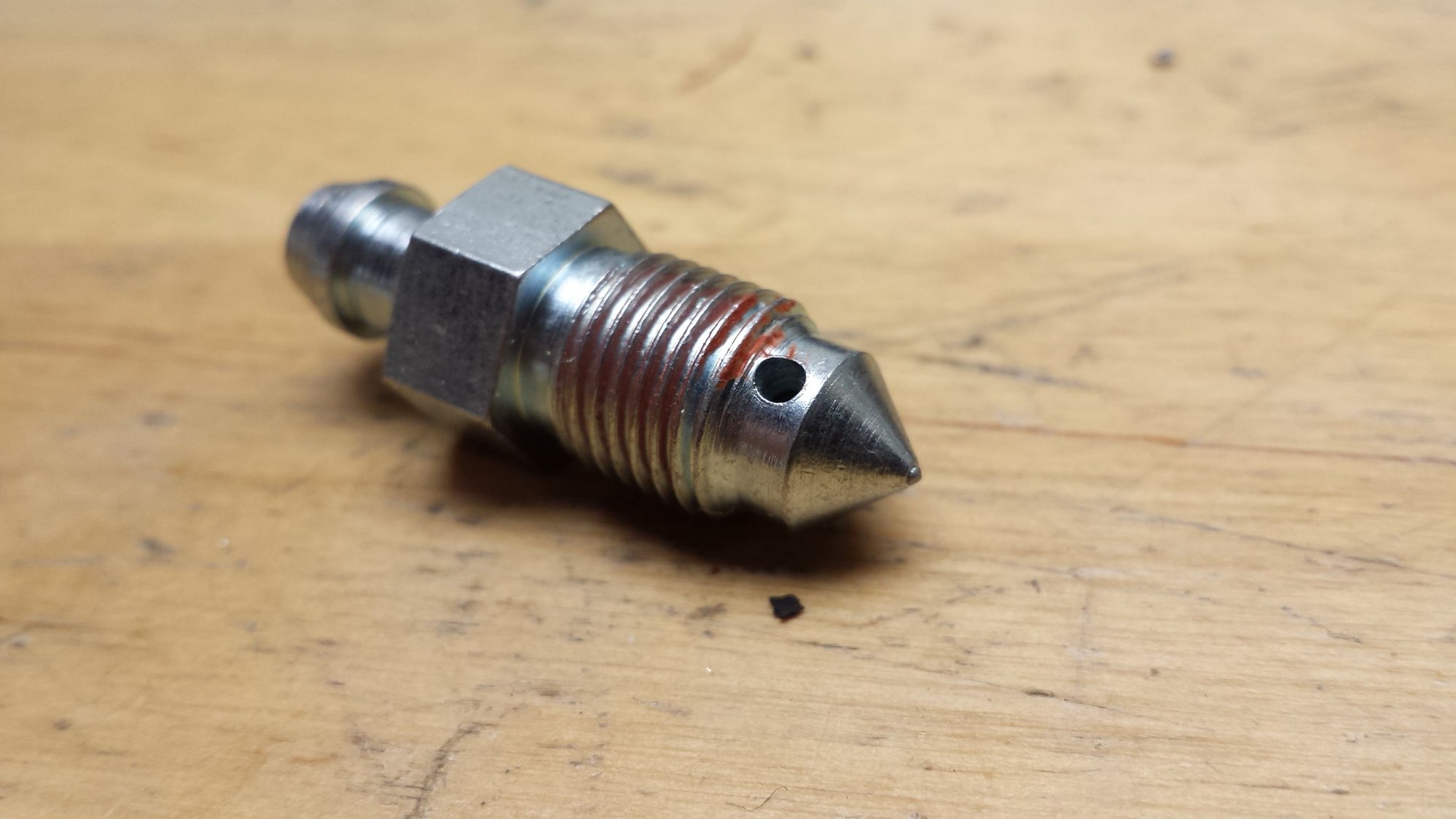

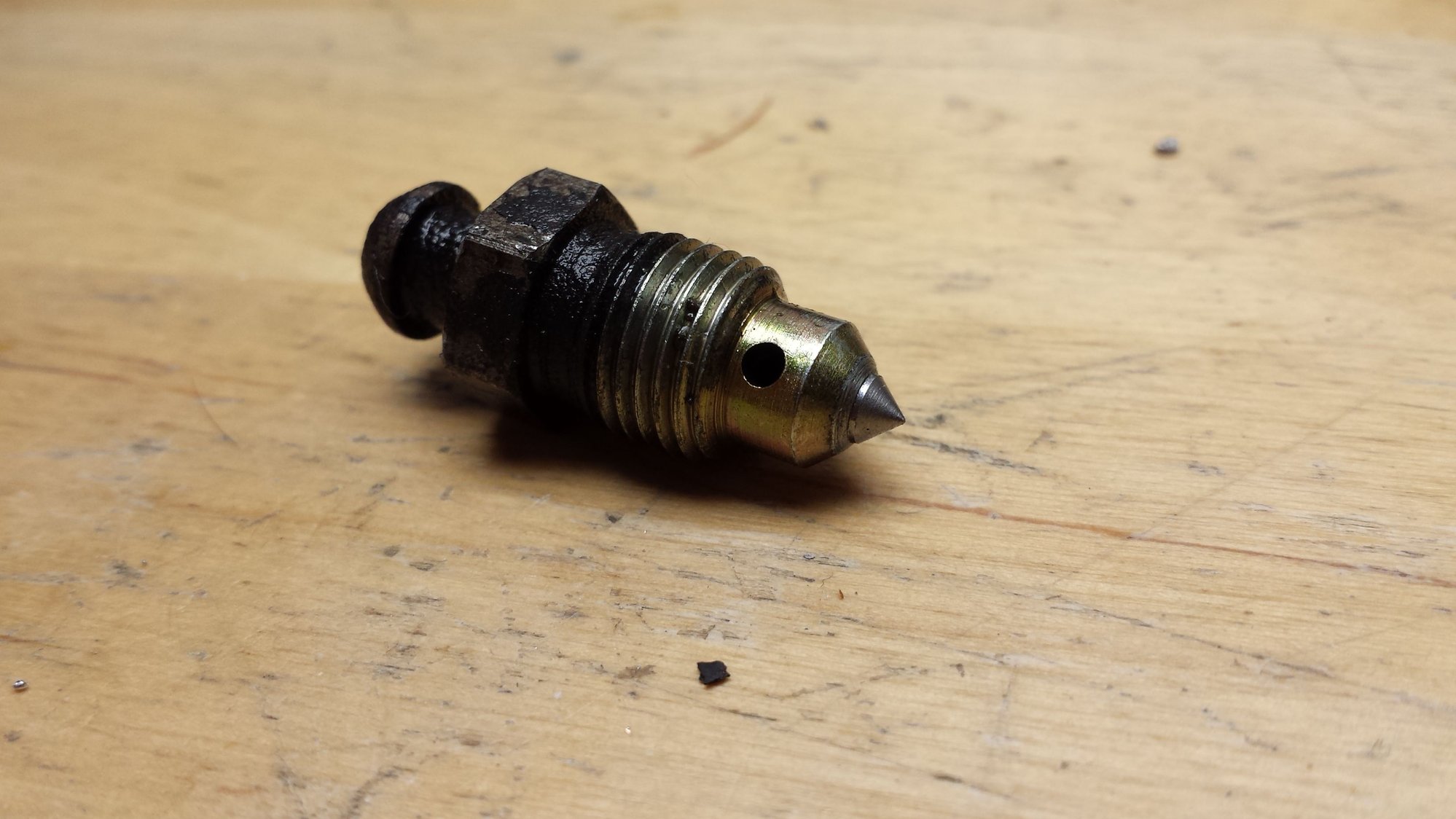

Thanks for this parts info. I could find something in a local parts store and pick it up this afternoon. The tip of the old bleeder screw has an uneven impression, which might explain why it was leaking. Installed the new screw and so far after a few miles it doesn't leak anymore, but I have to check tomorrow again. Otherwise perfect fit.

Those speed bleeder screws work GREAT! Mine are older and I paid $65 for a set of 4.

I paid $16 for the pair. Went on a 1,300 miles trip, brakes work great, no fluid loss.
