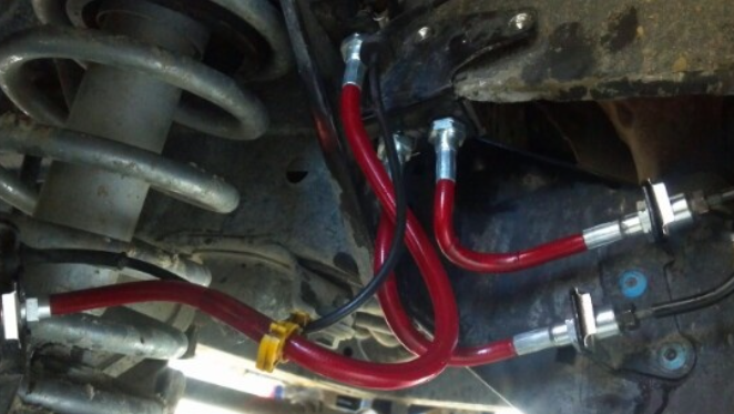

Hi
On a D2 there are 2 short rubber type brake hoses, not those down to the calipers, but these are integrated/attached into the steel brake pipes. Does anyone know the LR part numbers or have photos, pictures, details of these.
Many thanks

Hi
I think, hope, I have found my own query, LR part # SHB101350, can anyone confirm this is correct.
Many thanks

Hi JUKE179r, many thanks for the AB vid. You've cracked it spot on, it's the two short hoses at the front that are very rarely included in the stainless braided caliper hose kits.
Again, many thanks as it's ideal for my next venture into my D2, it looks like I'm going to be drilling out some rivets soon, but I have many 6mm stainless caphead nylock nuts and bolts and even some alu rivets to choose from.

Originally Posted by OffroadFrance
Hi
Many thanks
Yep, SHB101350 is correct.
