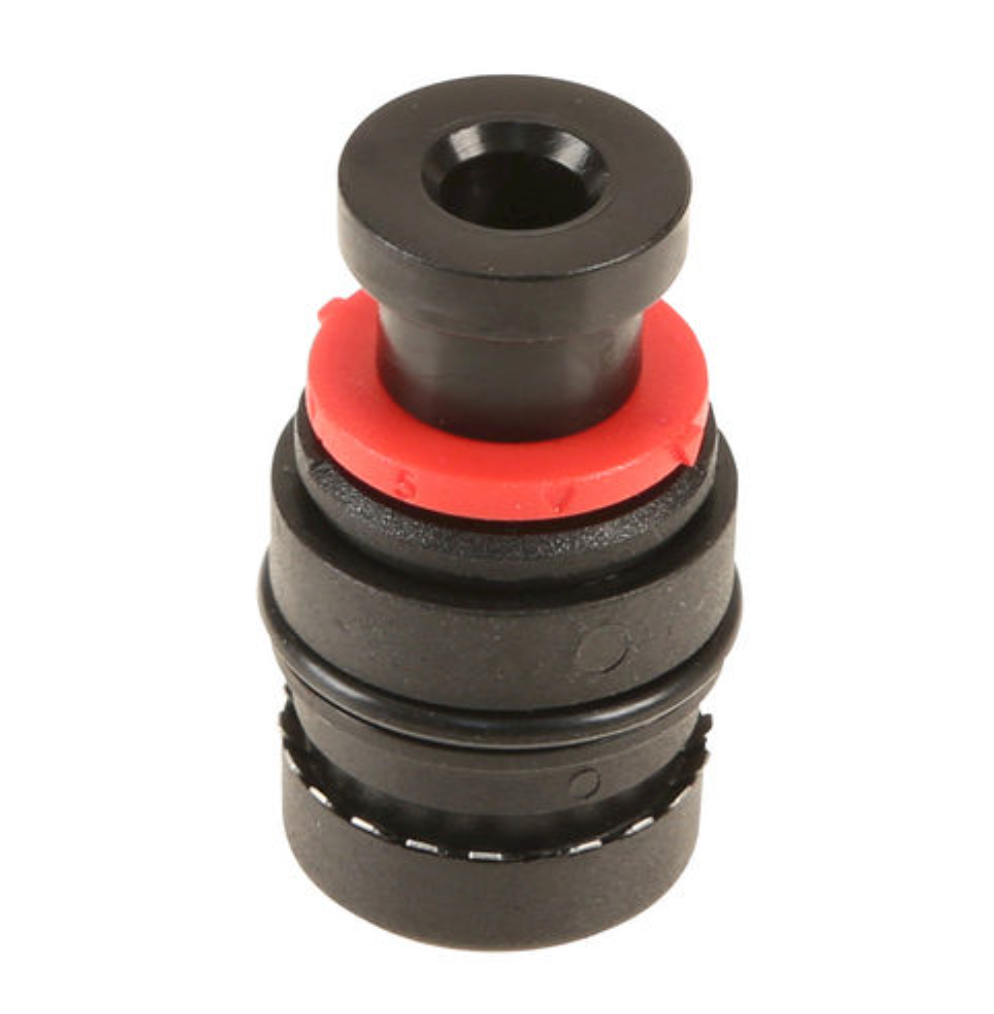

Reading on others posting with soft mushy pedal...noticed to check the vacuum line to the intake. On my rig, the vacuum line going into
the intake is a solid plastic line. On the intake where it inserts there is no black piece in front of the red flange that you have to depress
to remove the hose. I wonder if this is causing a vacuum leak... See the pic below. Came across another thread where a guy figured
out how to resolve removing the original one and putting a new one in. That black pieces on the outer side is for installation so you
don't distort the red piece during install.
