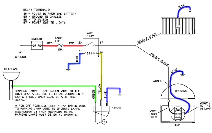

Re: How to wire or hook up fog lights?
Here's a wiring diagram that might help:
do you think you can use the existing switch? I dont see why not, we may have lights

Thanks for the great info.. I just have a question, why do you see some relays wired different. They use the 86 for ground, and use the 85 for the switch?? they use the same 30 for hot lead from battery, and 87 to the output (lights). Thanks
Based on the diagrams you posted, you should be able to swap the 30 and 87 as their just opposite ends of the same circuit. My guess is that the same is true for the 85 and 86...one needs to be the ground, and the other needs to provide power to close the circuit in the relay, but from your question I'd gather that it probably doesn't matter which is which.
I'd suggest that you just go with whatever the relay says when you buy one.

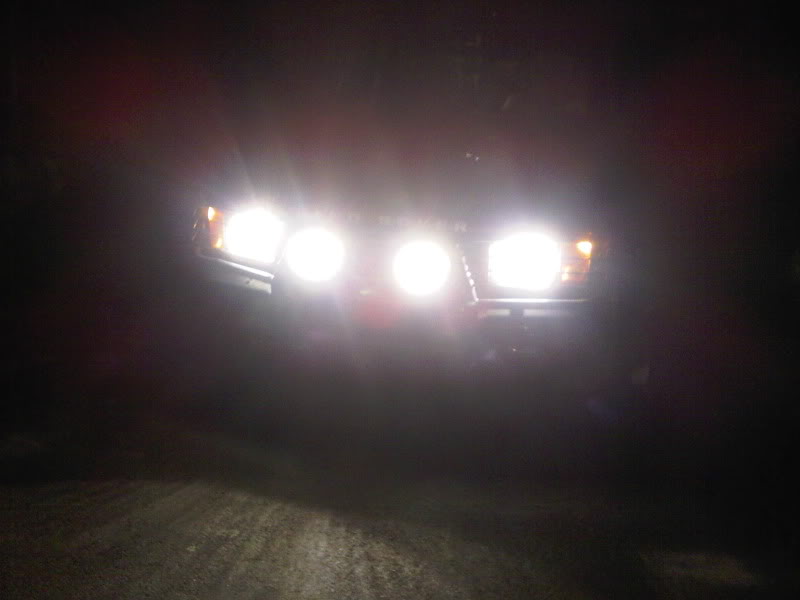

Success (for the most part)! So, went out and got a basic relay like shown. I was able to hook it up and have them fire when the high's come on. The switch is totally out of the equation now. I would like to have them switchable though, so I still need to figure that part out. I will take any advice on how to wire that up. The unused wires I have are:
Red and Blue coming from factory switch
White which is live when the ignition is on regardless of what lights are on.
What I wired:
Fused positive from battery
Negative to chassis
Both positives from lights together (negative now both to the chassis)
Blue/Orange from the high beams as the trigger.
Any ideas on how to get the switch to work? Totally stumped. Blew out a few fuses trying things out, and would rather now press my luck!
