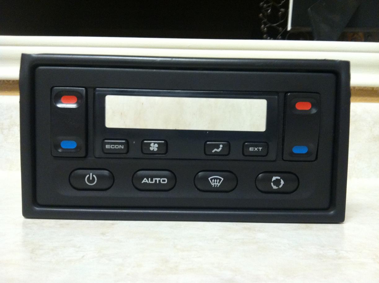

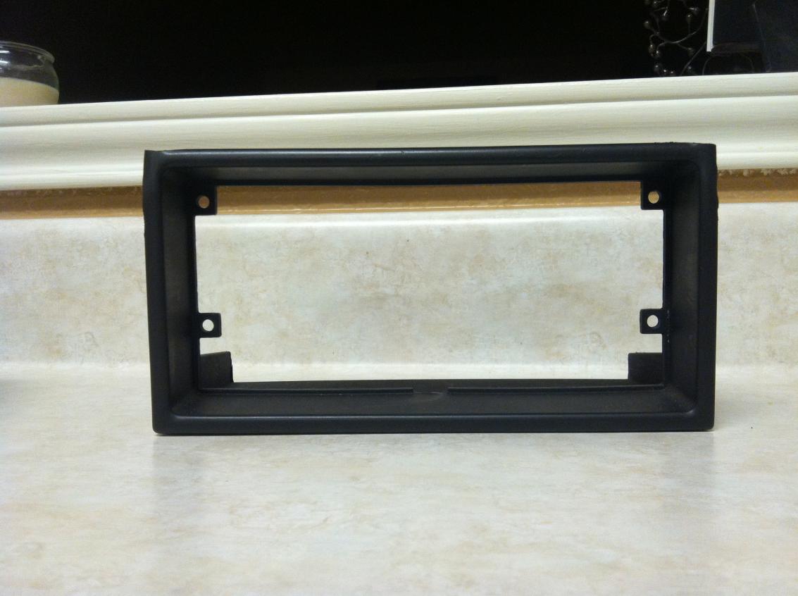

Well here is the 1st step. I cut up the old center dash. ( I have another from ebay, because this one the tabs were all broken off, so perfect for this mod!)

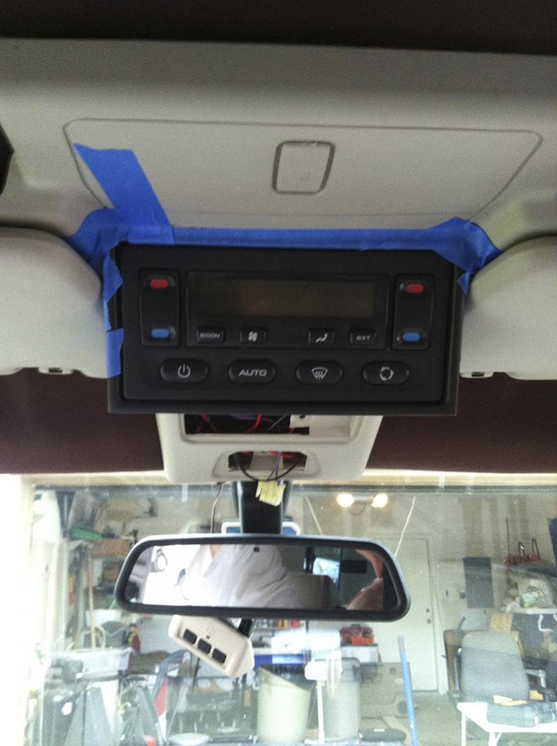

Overhead cut, Climate Control mocked up. Next up Fiberglass and Bondo. Then on to the task of extending the control cables.

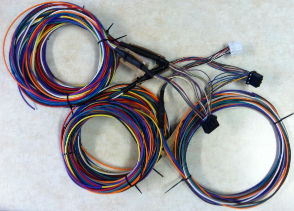

Well this project had taken a back seat for a while. Tonight I finished assembling the wire harness. I ended up purchasing 18awg wire off of ebay for around $40. It consisted of 10 colors 50 feet of each. Which was plenty.
I cut 10 ft sections and then created a wiring diagram. The wires were spliced with uninsulated butt connectors and then individually heat shrinked. Once all the single wires were terminated and heat shrinked I heat shrinked the bundle at the connectors.
