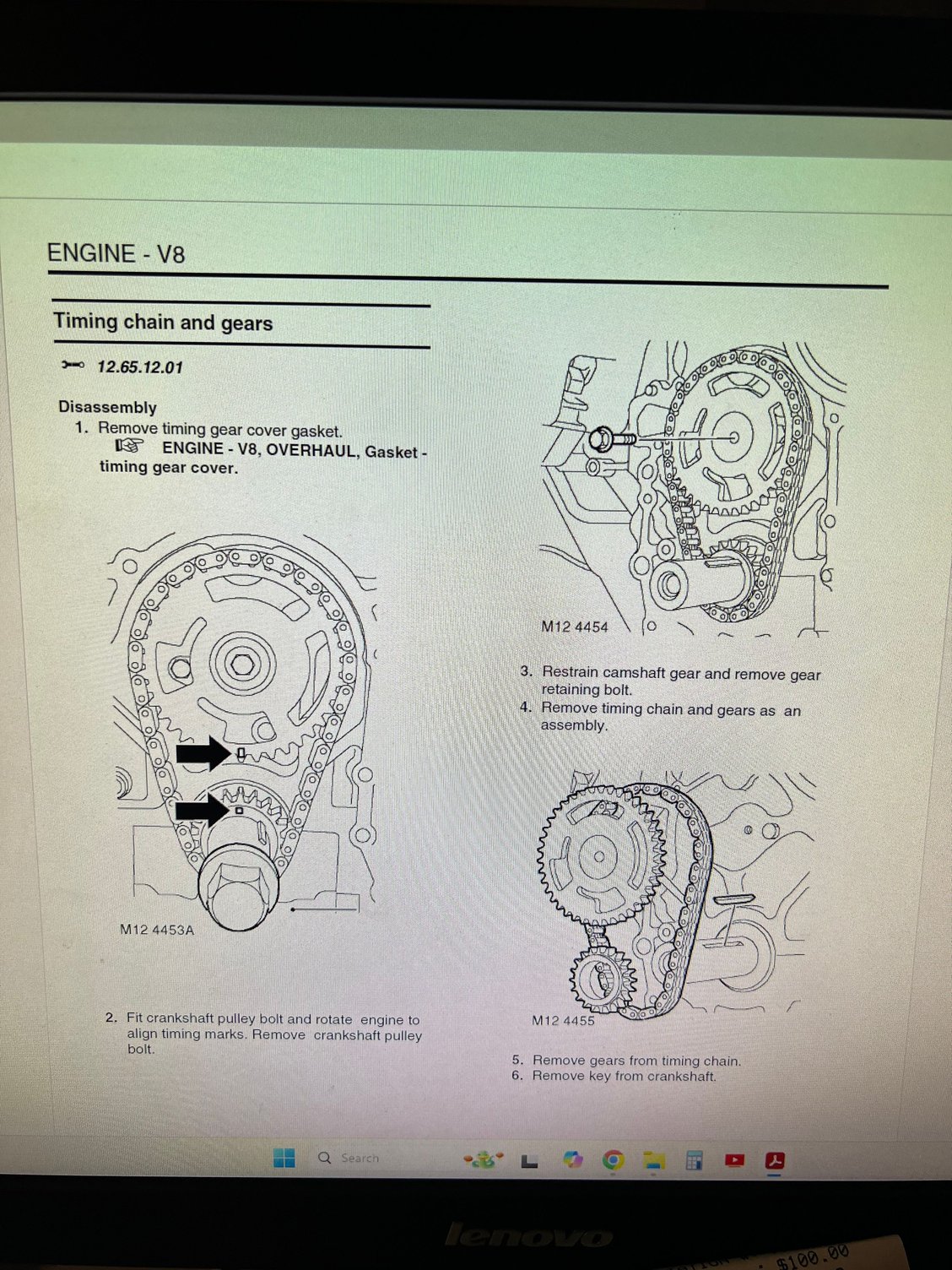

understandable, was hoping someone has done this recently and could tell me what exactly the process would be

Here you go…

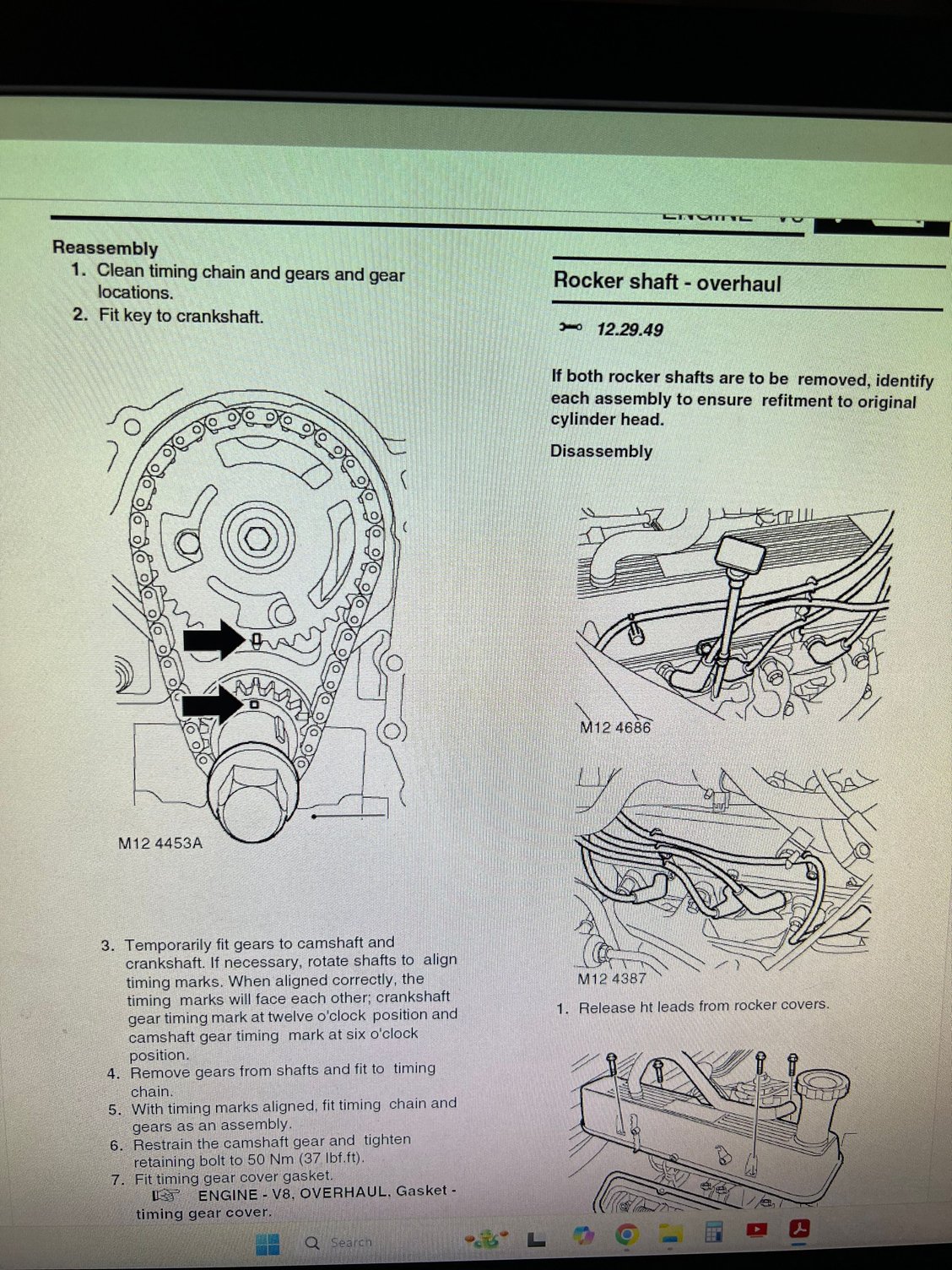

line up marks, take off. line up marks put back together. Not sure how there is conflicting info on that.

Thank you, was just looking that up in the rave manual

some posts and videos only talk about either lining up marks before or after not both and some also mention something about cylinder one being at the top and some talk about marking actual camshaft. so basically make sure timing gear marks are lined up before removal and at install
