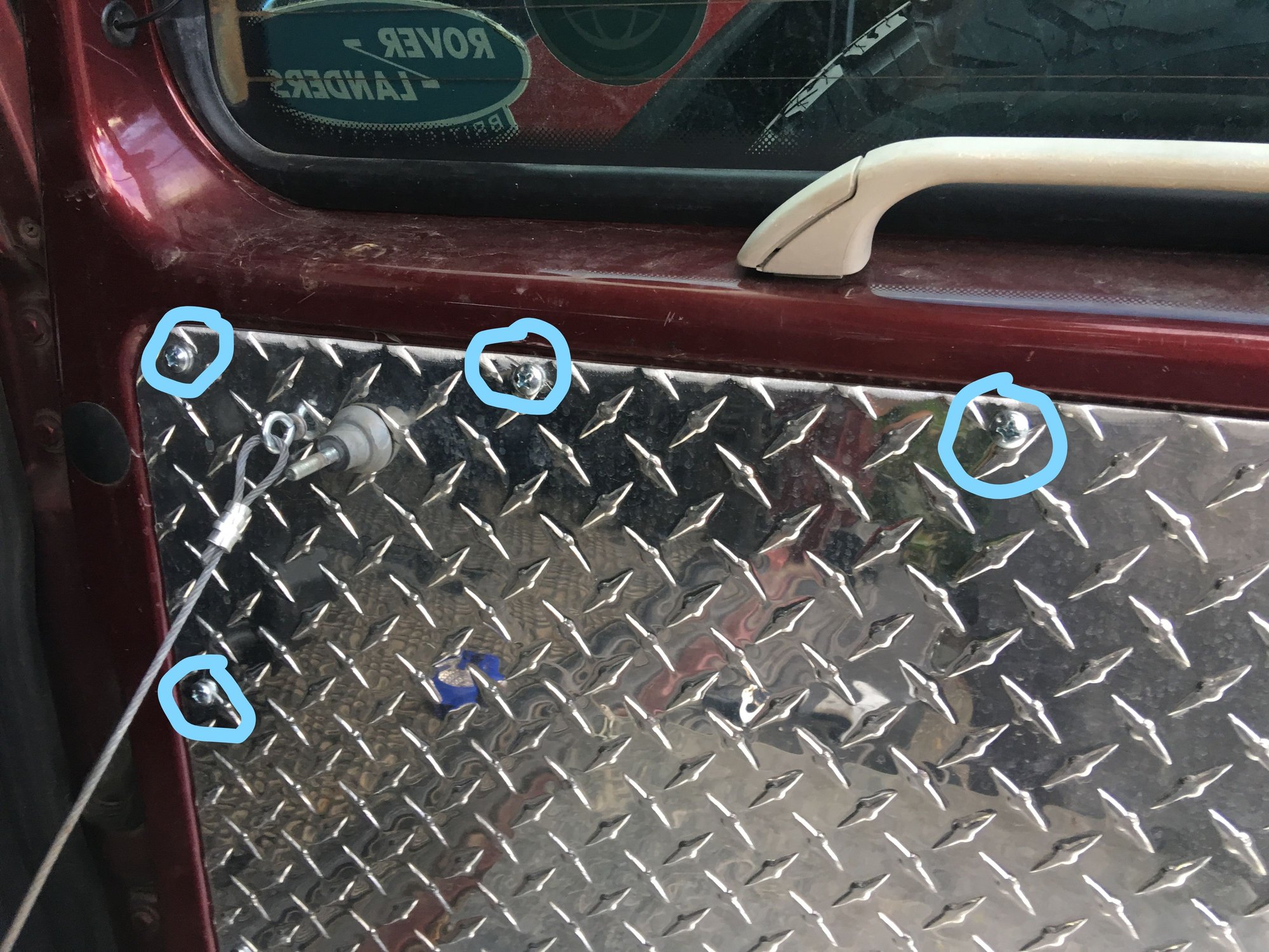

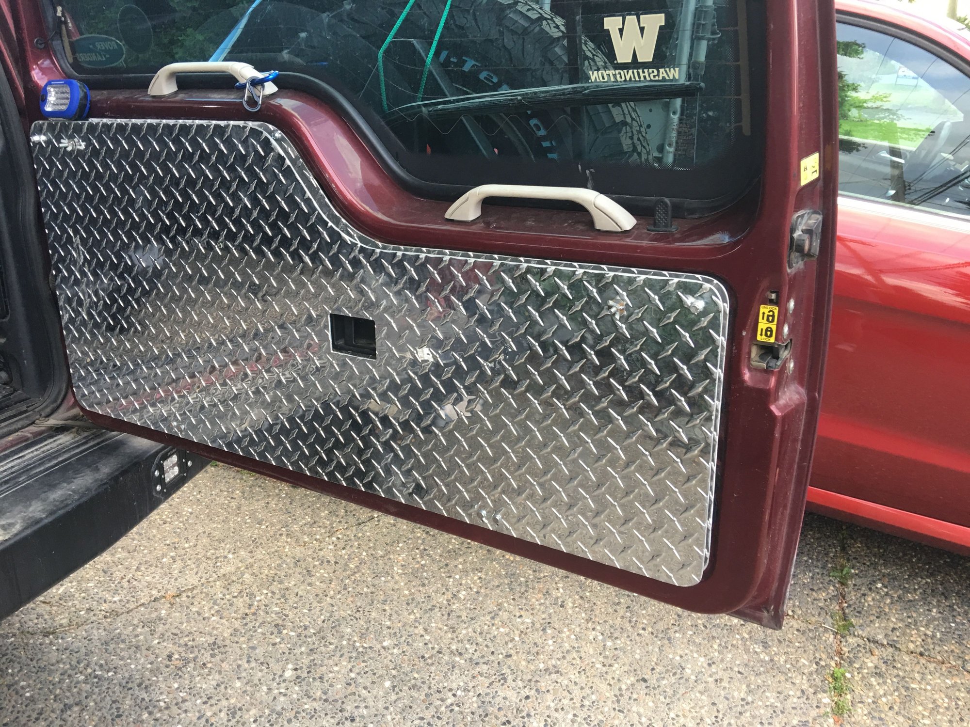

This is how my cooking table is made. Rivnuts secured to the cargo door, then the diamond plate panel is bolted to the rivnut base (circled).

I made and attached mine in a similar fashion (but out of wood). I then used a CNC router to carve out a recess so I could have a drop down table without it sticking too far out. I like the handles you put in your cargo door!
