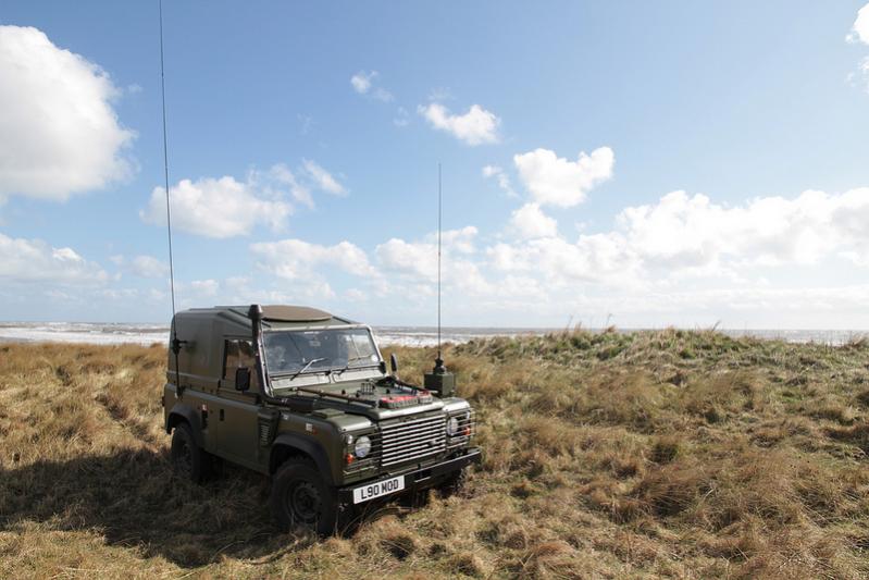

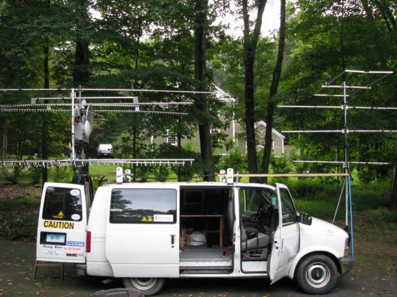

Some just skip the repeater.....
Attached Thumbnails CB, Spare Tire, Grounding Strap?-6898588260_21f6145662_c.jpg   CB, Spare Tire, Grounding Strap?-img_0005.jpg
