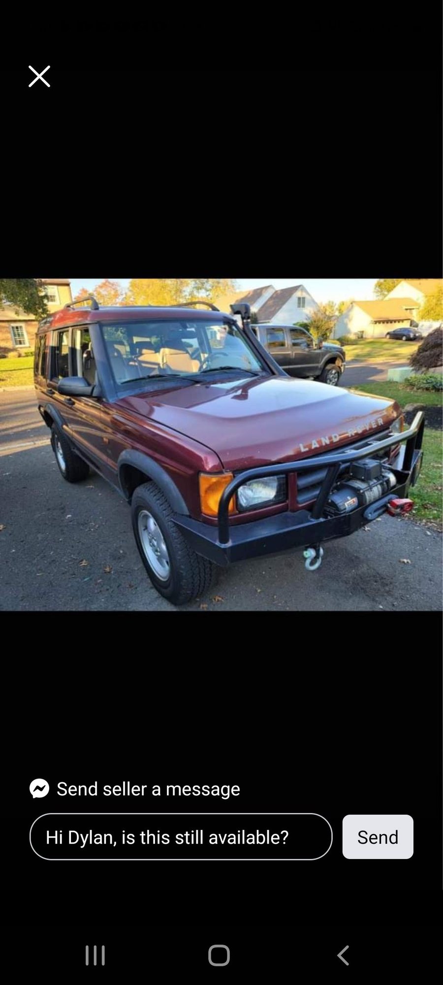

Just curious if anyone has any ideas about what the best route would be to get a center locker in my 02' discovery, or should I not worry about it for now and buy a Detroit truetrac for the front diff and a Detroit locker for the rear? Just wondering what you guys think the best option is, I'm new to the land Rover scene, the truck already has a winch, snorkel, 3 inch lift, and 32" all terrains. The picture is still from Facebook marketplace because I bought the truck yesterday.
