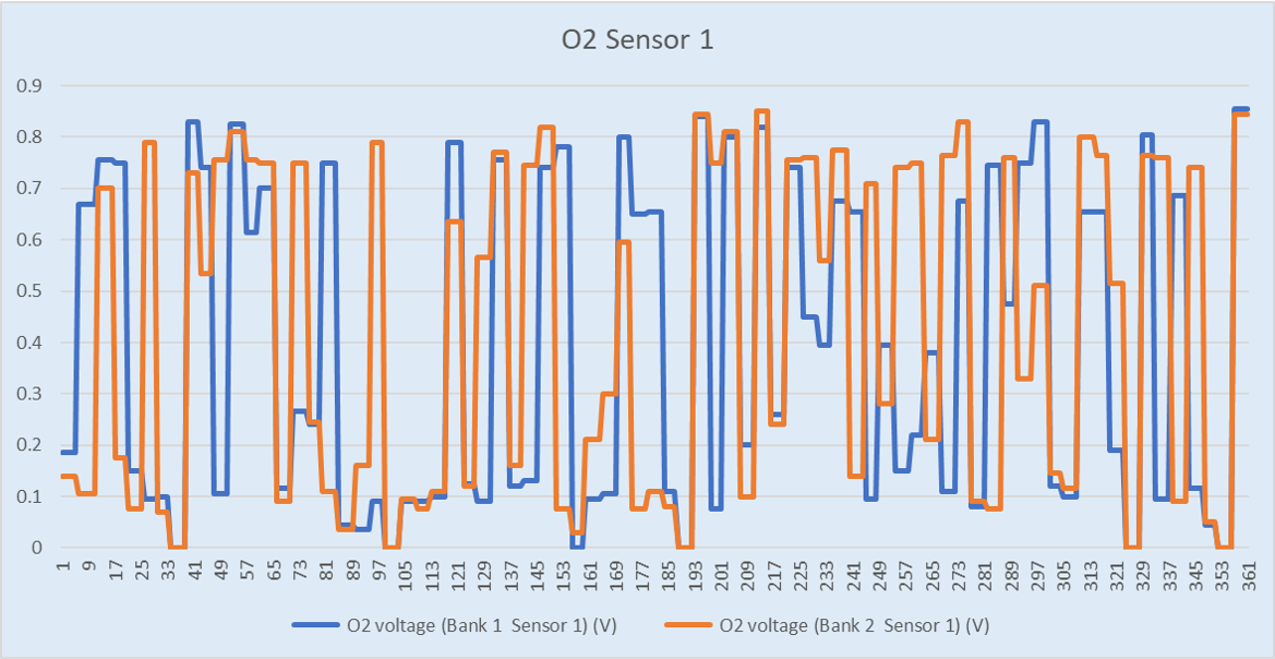

OK - making progress...
O2 sensors. Bank 1 and 2 sensor 1.

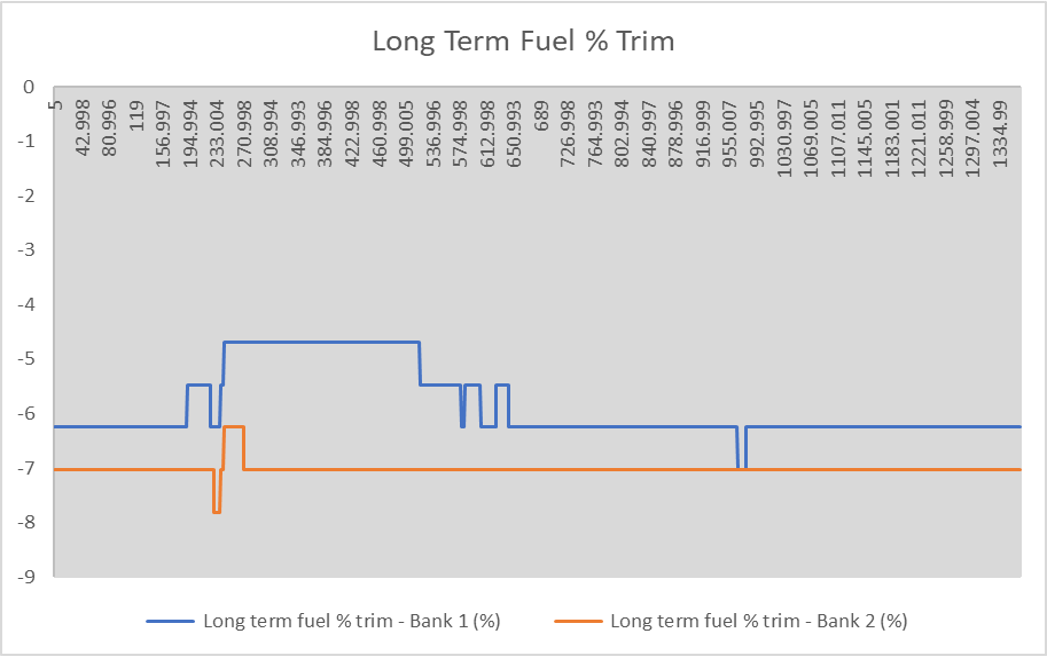

Long Term Fuel % Trim.

So, good news. Those trends look good. ECM is controlling fueling between rich and lean using O2 sensor feedback. Both banks are very similar, with similar time responses. ECM looks for voltages crossing around 0.45 volts (stoichiometric), then adjusts duty time of the injectors (each bank independently).
Long term fuel trim values are similar for both banks. Pulling fuel back -6 or -7%, so no vacuum leak. Vacuum leaks usually cause fuel to be added. Not pegged near maximum limits +/-25%. New stock engines LTFT should be between -3 to +3% if all is well, but yours is not stock anymore, even -6 or -7 is not bad, nothing to worry about. Maybe caused by higher fuel pressure or higher flowing injectors? Doubtful leaky injectors, since that is very rare, especially since both sides are nearly equal.
Bad news is this data indicates a normal running engine, so does not help find the misfiring. Did you consider raising idle speed as a test? Will require more diag to get to the bottom of it. In the mean time, enjoy the ride!
