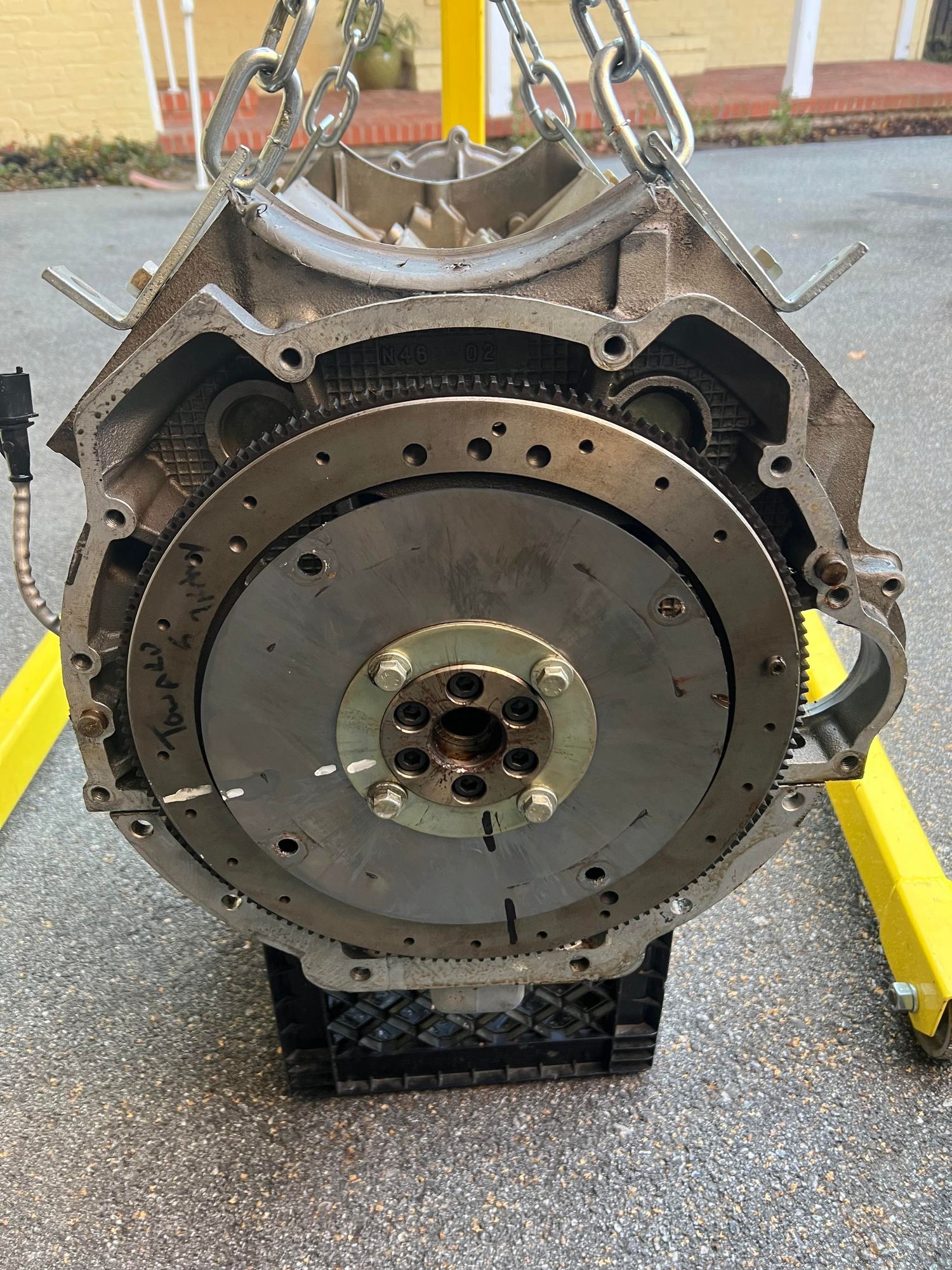

My understanding is the misses are generated during idle, not while driving under load. Correct? That may rule out knock, but higher octane (or an additive) is an easy thing to try. Also easy to try the MAF disconnect.
Interesting no miss on 6, maybe a clue. What does the builder have to say about this issue? You have a lot of brain power working with you. Maybe take a look at the reluctor ring on the new flexplate to make sure all the pins are straight/properly spaced. There's a little tool gauge made to measure the gaps if you go that far.

5 was absent too - until recently. But they all come at once after warm up and left to idle for a while. The consistent offenders are 1,2,3,4,5,7,8.
The builder, TWS, who I trust, says the compression and cam aren't big enough to cause issues.
I've been running the Ashcroft flex plate for a while - but no reluctor rings. Do you mean the flywheel?
